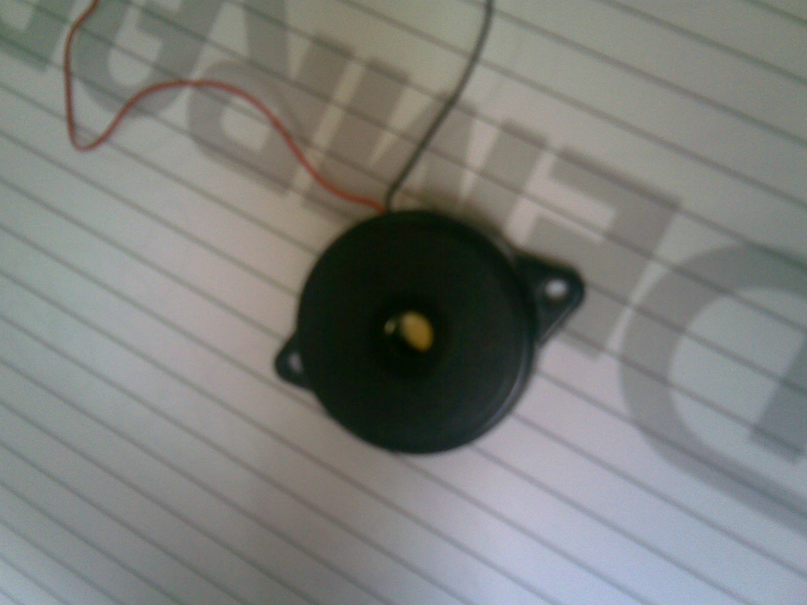

piezo transducer???
19112006-jpg.10240
Dr.EM said:
Are you thinking of piezo transducers? They require a different kind of amplification (low current but higher voltage). Only really effective at a tight frequency range though.
I don't know its name is piezo transucer or something else. I attached it to see. It has a round golden color metal inside that a smaller circle from another kind of metal is stuck on it.
Anyway I don't know how to boost its output voice.
I don't know its name is piezo transucer or something else. I attached it to see. It has a round golden color metal inside that a smaller circle from another kind of metal is stuck on it. please see the picture in this link: https://www.electro-tech-online.com/attachments/19112006-jpg.10240/

Connect it to 9V battery, if it beeps then it's a buzzer but if it makes a click sound then it's a transducer.
The piezo beeper or transducer is packaged in a tuned resonant cavity (its black plastic case) so it will be loud only at one frequency of from 3.5kHz to 5kHz. If it is not in the tuned resonant cavity then it won't be loud at any frequency.

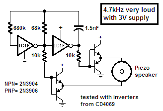

I played with a piezo transducer when I looked at a Keys Finder Project and its frequency needed to be carefully adjusted to its resonant peak for it to be loud. I used only 3V for a supply and a bridged amplifier driving it. Two Cmos inverters didn't provide enough current to drive it (not even when paralleled) so I used complimentary emitter-followers.

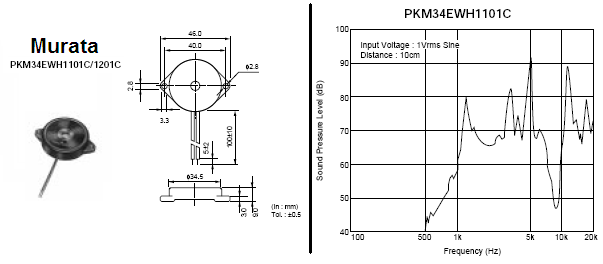

I have two frequency response graphs of piezo transducers. One is absolutely horrible. This one is also horrible but it is much better than the really bad one:
