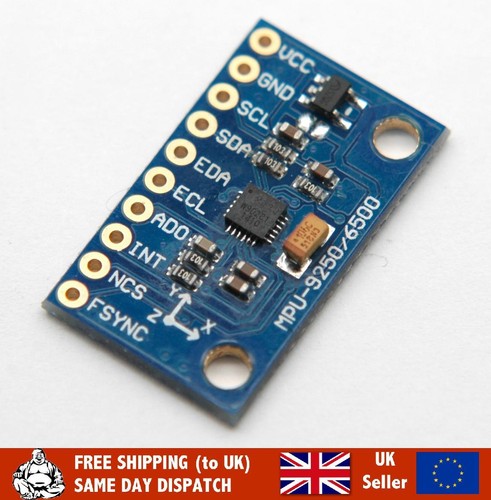

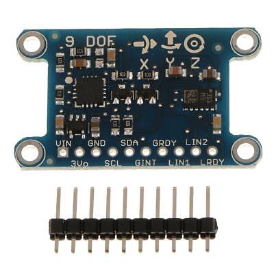

An alternative approach could be an accelerometer sensor as used in phones & drones etc.
Those are now extremely cheap and you can set any thresholds you want in your device, including shock/acceleration and tilt limits.
No moving parts and nothing to wear out.
They do need a microcontroller to continuously read data, but that can be a PIC or Arduino etc. that also costs next to nothing.
It would also give you the possibility of extra options such as for an alarm if the bike is dropped, even when the security alarm is not set - or any other abnormal movement, plus delays etc.
Examples:
Or with a compass as well:
Plus altimeter, even:

OK, great! that should make it fairly straightforward.
If you are using one of the original 8 pin devices, have a look at the 12F1840; those are far faster with many more facilities, including hardware comms and I2C etc.
I've found a few local IOT and Arduino specialists selling ADXL335 breakout PCB's. That's good news so I'm not tied to a single supplier.
I've got a bunch of alarm PCB's partly assembled using the 12f675. The chip is socketed.
By pulling a couple of existing parts, the ADXL335 can be mounted in the existing enclosure and hooked up with a little wire.
And the micro reprogrammed.
Once the existing stock is used up I'll redesign the unit.
Interestingly , bare chips from Digikey are more expensive than an arduino daughter board
A couple of chips are ordered and should be here by weekend ( I live away from the main centers)
With a little overtime, V2.0 could be ready to go in a week.
