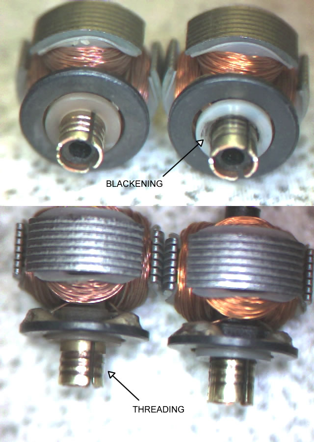

Recently we have been having issues with motor life at work. They are brush-type PM DC motors used in airplane servos.
Lower voltage improved life, as you would expect. But then we lowered the voltage a little more, and lost a couple hundred k off the average life.
Someone at work suggested we may be seeing this effect -
If the current density exceeds this for long periods, the commutator will run hot, blacken and brush life will be reduced. If the current density is too low, the film will be stripped from the commutator and the commutator will begin to thread.
The effects on the commutator seem to verify the effect, but I am having a hard time wrapping my head around why a lower current density would ever be detrimental to brush life.
Anyone have any experience with this?

From the whitepaper, it looks like "film" is a protective layer that forms/reforms/strips away on commutators and that low current density erodes the film resulting in quicker erosion and wear of the copper itself; good film reduces these effects.
Erosion can be the result of improper film on the commutator or a wear condition such as threading. ...
The condition of the commutator film directly affects friction and erosion and thus brush life. In order to achieve good brush life, the commutator must have good film.
When electric current is passed between the carbon and copper in the presence of water vapor, a microscopic layer of copper carbon composite or film, is formed. Good film is chocolate brown or burnished bronze to dark brown or black and uniform in color. It is not bright copper or burnt black copper. Consult a commutator color and appearance picture chart to determine the condition of the commutator. There is a condition known as false filming in which brush graphite deposits become cooked on the commutator resulting in an appearance similar to dark film. Oil can also leave a coating which resembles film. If this film can be easily wiped away, it's not the desired good commutator film!
Commutator filming is a continuous process. That is, the film is continuously being formed and stripped away. A good film is only 200 nano inch thick (0.000,000,2 inch or 0.000,005,08 mm). Thus the conditions required to build good film must always be present. Changes in current, humidity, etc. will affect the commutator film.

The coefficient of friction between the brush and commutator increases approximately as the speed. Brush wear is proportional to the coefficient of friction. At higher speeds, above 5,000 or 6,000 fpm, greater brush pressure may be required, resulting in decreased brush life. At high field weakened speeds, commutation deteriorates, that is sparking increases. At higher speeds the film can be stripped from the commutators faster than it is being formed. If the motor runs at high speeds for only short periods of time, film can still be maintained.

The current is proportional to the voltage. At 5V, it is an amp, at 3.6V it is 680ma. There is no compensation by the PWM circuit in this Futaba S3154 servo for torque, no current detection. It's a simple H-bridge driver, the only feedback is the pot. Decreasing the voltage proportionally decreases the motor current, brush current, speed and internal temperature.
The motors drive a fixed load (a steering assembly in a model car) on a static life tester and a dynamic load on a test track, there is good correlation between the two. We test 12 on the static tester and 4 on the track continuously to failure. Our sample size is not huge, but we have burned out several dozen so far and have some confidence in our estimations of the mean time between failures. Servos are disassembled and inspected to verify the failure mode is burned out brushes.

I'm stuck with this particular servo. We designed an image recognition system that locates the cars on the track and predicts the path. Other servos we tried have drift with temperature that throws off that prediction (other servos use RC oscillators, this one uses a crystal, that seems to be the thing). The temperature changes quite a bit depending on how heavily the game is played.
Life is important because operators expect a certain ROI (return on investment) with coin-op games, basically that it pays for itself in a few months with no problems. It's a $20,000 game, 25 laps for $1, 4 player stations (so $1 to $4 per game, depending on how many people are playing) - anyway, it works out to about a half-million cycles we need out of that servo. We're close. We had the mean time between failures over that when we dropped the servo voltage from 5V to 3.7V. Now we're under it again. I lowered the servo voltage to 3.5V. Could lowering that voltage by .2V really cost us some 200k off the life? I'm looking for other explanations - we didn't chart humidity with our life tests, perhaps when we did the earlier tests in the winter, when the humidity was lower...
My question was if anyone had experience or knew anything about this strange notion that lower currents can somehow reduce MTBF on motors. It fits with the tenuous data I have, but doesn't make a lot of sense. Doesn't sound like anyone has any information on this, (figured it was a long shot) but I appreciate the replies.
