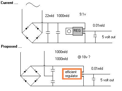

Here is a small switching circuit that gives a 5 volt
controlled output from a fairly wide supply range of
input voltage, so that as it falls, the 5 volt should
remain until the input falls below 8 volts.
Unlike a straightforward regulator, this circuit does
not act like a dropper resistor and waste power, the
designer claims efficiences better than 88 per cent.
It might be worth a look.
* 80% efficiency (from 30mA to 90mA out)
* very tiny Rf inductor
* very cheap circuit (under 50 cents in parts!)
* good 5v regulation
* input: 8v to 20v?
* output: 5v @ 150mA maximum
I would also suggest rewiring your rectifier circuit
to give around 18 volts which would mean it holds more
energy, and hopefully lasts a little longer.
Best of luck with it, John :)

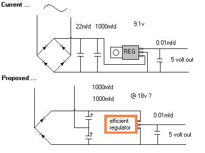

Hi, John
i've made some corrections on Your sematic...

Thank you sebi !
But what did you think of that little regulator ?

Hi McGuinn,
Thanks for looking at my suggestion,
however,
you have muddled up a couple of little bits.
The extra efficiency i suggested is from using a type
of regulator that does not waste power.
Did you check out that page i gave ?
Most regulators do not act like that.
And you are correct that when rectifying and smoothing
the 6volt ac you get 9.1 volts.
However,
you can also rectify it and smooth it the other way
round, and get a negative 9.1 volts.
If you arrange that the two 9.1 volts are added,
then this uses exactly the same ac supply,
but gives almost double the voltage out.
The AC supply can do this without any change.
You can use the same AC supply to give 9.1v or @ 18v
simply by altering the rectifying arrangement.
Doing this will not require the AC supply to be
altered or changed in any way.
A higher voltage will hold more potential power and
in conjunction with a higher efficiency regulator
may give you the three seconds you need.
It may even give you some extra time using a standard
regulator unit.
Using larger capacitors will help with the supply at
9.1 volts, but the rate of voltage drop will soon
bring it down below the regulators range, by
increasing the voltage applied to the regulator you
will improve matters, if you also increase the caps
you might get it to give three seconds simply by
using the doubler as shown and bigger caps with the
regulator you are using now.
I hope my attempts at an explanation can be
understood, its not easy trying to explain the
actions of electronic circuitry.

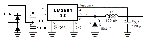

My opinion: use a voltage doubler rectifier and a small buck regulator e.g. LM 2594. I'm sure with two 1000uF cap. enough for 4sec.

I have just downloaded the datasheet for the LM2594, I will look at this instead of the other SMPS circuit. Lots of maths in the datasheet though, and I don't have an oscilloscope yet!

Don't worry about maths, just use the application example.
On NSC homepage You can make on-line design,but this cct. will work.
