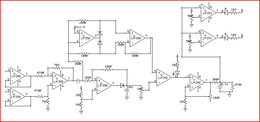

I have a signal around 500Hz that is roughly sinusoidal and has a peak voltage of around 4v when all things are well. When things go wrong every 6th peak is low at about 2v. I am trying to detect this low peak and activate an LED (also if 2 peaks every 6 are low a second LED is lit).
One problem is the whole siganl can be down to half its value or anywhere in between, so a good peak may be 2v and a bad one 1v. So I have tried to extract the DC level of the rectified signal to use as a floating referance to compare the peaks to. If a peak falls below the DC threshold it should light a LED.
However I am not able to detect the low peak yet.
Any ideas would be most welcomed.
The circuit at the moment is:-

My appologies, I missed out a very crucial word and that is 'it is NOT working' and so I was hoping for any ideas on whats up with circuit?

I think the referancing to Vcc/2 may be incorrect for the rectifiers hence my question to the forum.

The process I am trying to get is shown below but for some reason the circuit does not see the small peak? I think it is something to do with how I reference the signals to 0V as this is a single sided application.
Any ideas on why my circuit is not working and where to start looking would be most useful.

Are you familiar with a centrifugal pump. Each time the blades pass by a sensor then it gives a pulse. If the blade is broken then the pulse is lower and so the system should be able to detect either 1 or 2 or maybe even 3 broken blades.
Using a PIC is a problem as there may be any number of blades between 6 and 20 and the RPM may be anywhere between 400 and 5000. Once the gear ratio is known the pulses per second can be calculated and the range will be very wide. The 500 Hz is just for this application only.
The idea is to set the DC level via a pot for a new pump so it just does not light the LED, any loss of blades will then be detected and it should be easily settable for any system.
Lets say the signal is from a LVDT then another problem is surge, this is when the pump has too high a backpressure and cannot pump any more so it loses traction and the flow stops, once the flow has stopped the pressure falls and pump gains grip and flow resumes. During this phase the pressure variation across the disc of the pump moves it back and forth and hence closer or farther from the LVDT. This modulates the signal and so the the detector must be able to track this modulation as well and not give a false alarm.
Its an interesting but tricky application.
