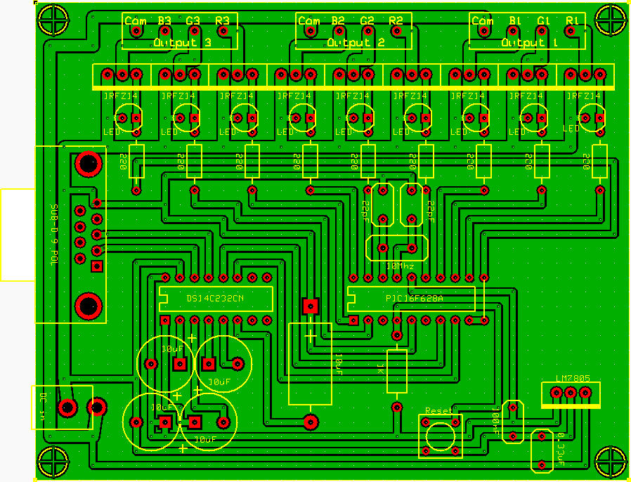

Hi all,
I have been working on a small circuit the last few days which is designed to be an RGB Led Controller.
I am no electronics expert and have been learning as I go, but I've hit a problem with my finished board and can't figure out what is happening..
The circuit was built using the diagram attached, and everything is indentical except I had to use IRFZ44N fets as I could not source IRFZ14 locally..
Now to the problem.. all the leds on the board work (they are just there for testing so you don't have to attach anything to the outputs) but I get very low voltages from the actual outputs - all of them are giving around 0.02v - 0.08v, it should be more like 12v!
I have metered the voltage at the gate of the fet and they are all around 2.02v
Have I done something wrong or has the change of components screwed something up ?
Thanks!

We need your schematic. Your gate voltage is way too low to turn on the IRFZ44. John

Hi Neil,
No. Gate threshold is where the gate starts to turn on, and can explain why your output is so low. You need to fully turn on the gate to have it act like a switch. For the Mosfet you are using, that is approximately 10V.

Yes. What you posted was the PCB layout. The schematic shows symbols, part numbers and values, and connections.

Hi Swifty,
The leds are connected accross the gate-source junction of
the mosfets. This will prevent the fets to be driven. You
should at least get 4 to 5 volt drive to get anything out
of the fets. Check the Vgs/Id characteristic in the datasheet.
You need to remove the leds to get the thing working!
The output voltages will always be zero because the drains are
connected to the outputs, this means that you need to connect
the external leds with the anodes to the + 5 volts (com ?)
and the cathodes go to the drains of the fets. And don't forget
to put a resistor in series with the leds to limit the current,
otherwise the fets will fry the leds.
Have much fun !
on1aag.
Thanks to both for your help.
John, the info for making the board definatley states IRFZ not IRLZ..
on1aag, thanks for your input - I _think_ I now understand what you are saying; If I look at the datasheet for the fets it says the threshold is 2 > 4v so above 4v the fet will begin to output ?
And the fets are only getting around 2v because ~ 2-3v are being sucked by the leds which are inline with the supply to the fets?
Hopefully I have understood that correctly :)
Thanks!
Ok in answer to my own question I guess I understood things correctly!
I have just desoldered the +ve leg from one of the LEDs on the board and I now see 12v at the output for that channel!
Thank you so much o1aag!
