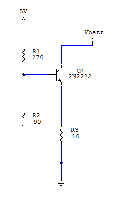

This circuit is somewhat simpler. Current draw is set to about 50mA, but can be adjusted by R2, or R3. Simple series voltage regulator across fixed load resistor (R3), thereby drawing constant current from battery. Works down to a least .8V, but somewhat less. Cheers.

Thanks! I'm going check this one out.
