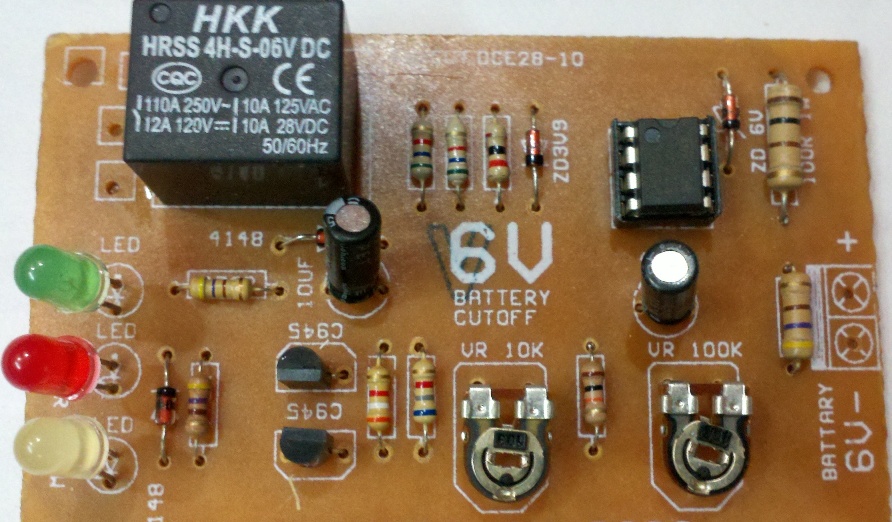

Hi
What is **broken link removed**thing and what does it do? I googled "6v low voltage cutoff" and found **broken link removed** somewhat similar looking circuit. Please help me with it. Thank you.

They cut the supply off (via the relay) when the battery level goes below a point to protect it.
Thanks.
The red LED is for power indication in the circuit and the white LED is for low battery indication.
Will this circuit cut the supply off when battery voltage is 6V or lower?
Is that component on the top left a relay?
What is that IC on the top right?
Please help me with the queries above. Thanks.

They removed the part number from the IC so you will not copy the circuit. It is probably an LM393 dual comparator.

Someone was saying that the circuit uses operational amplifier. Is this possible? Please let me know. Thanks.

I love it! Battery Cutoff with two terminals to connect the "Battary". I figure the battary is much like a battery. :)
I agree with AG. Note the ZD designations for zener diodes. The relay is for likely removing the load when the battary voltage droops.

I have attached a picture of underside of the PCB. It might help you to see if its comparator.

You have the board, so make a schematic of what you do know as to the parts. Looking at pictures of a board isn't anything but a guessing game for us, unless someone has the same identical board they may have seen or worked on in the past. Make a schematic and post it.

It might be a kit but the etching of the pcb is pretty bad. The transistors are Oriental ones. It has a 3.9V zener diode and a 6V zener diode.
A 741 opamp is 44 years old. It was designed to use a 30V supply. Many will not work on a supply that is only 10V or less.
Its inputs must be at least 3V above the negative supply and at least 3V below the positive supply. With a 5mA load its output might have a 5V high and low loss.
You can do it with a transistor, relay and zener diode. Plus a few parts
