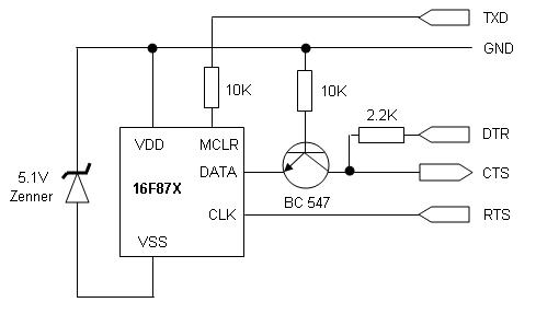

I’m programming my PICS through serial port. I’m not giving any supply voltage from outside.
Also I never enable LVP fuse but its programming nicely.
Is it my circuit is a low voltage programmer or high voltage programmer?
Thanks.
Thanks.
Serial port can supply 13 V for high voltage programming. I use parallel port programmer.
Not sure about yours, I wonder why the GND is connected to Vdd pin?
Maybe it uses a positive ground?
It looks like it is neither because Vss of the PIC is not connected to anything except the zener. Unless they are using the PICs internal diodes to feed the (-) from the signal leads. Definitely something I wouldn't rely on. Does it actually work as wired?
