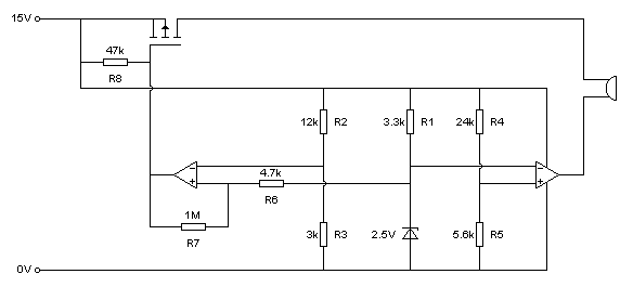

I am looking to design a small circuit to sit between a Li-Po battery (14.8V) and the rest of the modules (Video Processor, TFT Panel, etc) which require regulated 12V@2A.
It also needs to have a low voltage output that can fire an LED/Buzzer before the over discharge circuitry within the Li-Po battery cuts everything off.
On my journey through Google I came across a MAX932 which could be used as a window comparator, then maybe use it to fire up Linear 12V reg (obviously rated around 3A)?? Just wanted to run it by you guys in here to see if this might be a decent way of doing it or whether or not there are pitfalls I should be aware of by going down this route.
Alternatively if there are other better options I would dearly love to hear them (cheapest of course).

A simple comparator and a voltage reference can be used as a low voltage alarm and shut down - no need for any proprietary ICs. I'll post a basic schematic if you like.

I posted my favorite low-voltage alarm circuit here.

Just make two LM431 cutoff circuits like I posted, where one goes off before the other. Actually, it seems you should use only one, with a fixed time delay to the second function.
Hi thanks for that guys, but I think I failed to mention that I need a second output to turn everything off before the Li-Po auto cut off circuitry turns everything off.
Then you need two comparators, the LM393 will do.
It won't be able to drive a huge piezo, only up to around 10mA, if you need a more powerful siren, you'll need a booster transistor.
