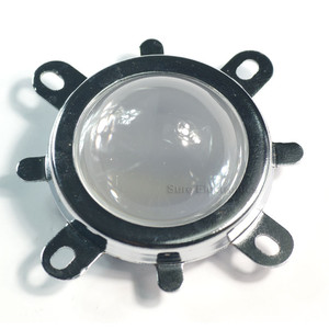

Another consideration is what your trying to accomplish, I've been playing LED lighting from 14.2VDC for some time for the purpose of lighting up the road ahead of me for off road driving and I have found that the 3 watt is the easiest to get lenses for and can be easily grouped. The 10 watt LEDs can be bought with a 60° lens built in, but the 3 watt lens angle can be as low as 5°.
Wow, 5 degrees, that's a pretty tight beam. My current light i modify a lot has a 10 degree optic, and that's pretty tight too so i could just imagine how more narrow the 5 degree optic would be. That would be very good for outdoors as i find that the tight beams are good for outdoors and the wider beams are better for normal indoor use in the home. I guess in a theater a tighter beam would be good too because of the longer distances involved. So it seems to go with the distance, the greater the distance the tighter the beam. Now to invent a variable beam angle optic ;-)
Cant you just adjust the angle by moving the light source in the reflector, or are we talking about a lens?
I'm playing around with the idea of a 10w led as a pushbike headlight, and you can get lenses for them off ebay, not sure what the angle is though.
For me, I prefer using 3 watt LEDs with either a 3 gang reflectors or single reflector, that's been the easiest and most versitle for me. Here's a bunch of photos of what I have done with 3 watt LEDs https://www.dropbox.com/sh/hjejcldjsdl5cfp/ozB1GLArvo with some other stuff also. Being as I'm using these for automotive, I have found that 4 in series works well and needs no limiting resistor.
