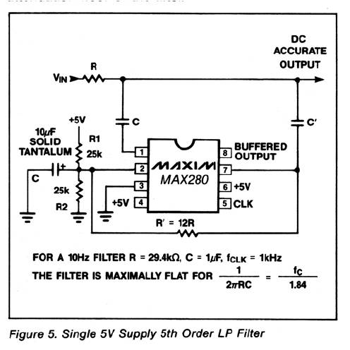

Hai Members
In the LPF diagram shown below
Input and Output are connected by wire
Does it filter work effectively? If so, How it works?

No, the way this filter works is that a special signal is coupled into the right end of the top wire via the capacitor.
Think of it as an RC filter, except that instead of the bottom end of the C being grounded, the IC injects a signal into the shunt capacitor, which modifies the output function. This is five-pole filter; if it where just the series R and shunt C, then it would be only a single-pole filter...
Thank you for the explanation
