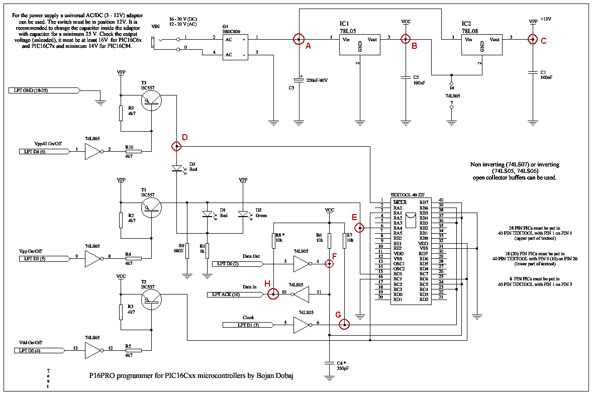

The red led and green led next to each other in programmer p16pro40 didn't light that is they didn't work and other red led did work...
I haven't placed my pic in the circuit yet , might be that the reason or likely there's another reason?!

could anyone explain to me about the general principle of p16pro40 programmer circuit?
It's VERY simple, just open collector buffers and switching transistors. If the LED's aren't lighting up, then you have something seriously wrong!.

All a parallel port PIC programmer does is 'wiggle' the output lines UP and DOWN, the hardware toggle buttons let you do this manually, so you can test the results with a voltmeter.
WinPicProg automatically detects the programmer on the port, so for a start, is it being detected? - the power to the programmer must be turned on for this to work.
Assuming it is, toggling Vdd should turn the Vdd LED ON and OFF, likewise toggling Vpp should switch the Vpp LED.
Hi 4electros,
Have you followed the schematic of P16PRO40 exactly? What is the part numbers of the 14-pin IC and PNP transistors you have use?

I have followed the schematic of p16pro40 exactly :cry:
Measure the voltages at the following test points A-H, without the parallel cable connected, no PIC in socket and just DC power to the circuit. Black lead of meter connects to 0V.
Post back the results.
