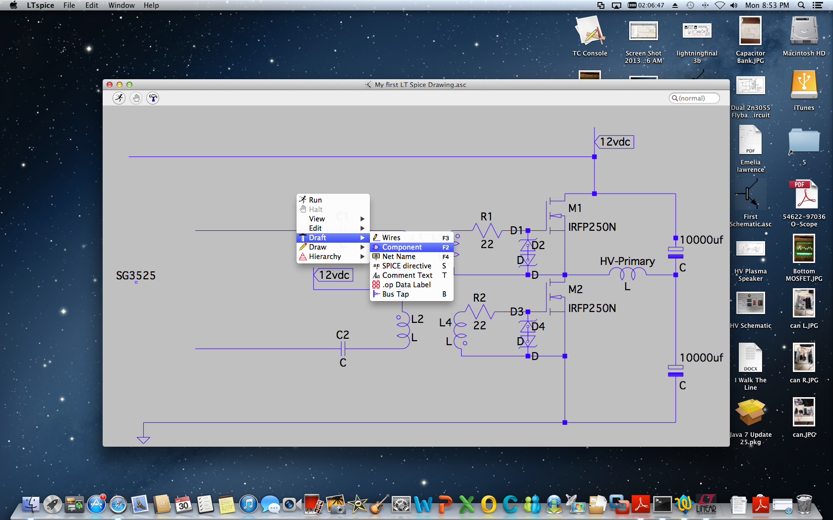

This is what I've done so far, maybe someone could sim a frequency or something? Choose another Driver, I seen some but couldn't figure out how I could use something in the Database?
This is what it's based on.
  • My first LT Spice Drawing.asc

So, I finally got SG3525 into the right directories and named (them) according to their file ext. How ever when I pull out the component and look to see if it's their, it's not.
So, I think maybe SgtWookie created them on a windows machine and I'm on a Mac.
Not sure.

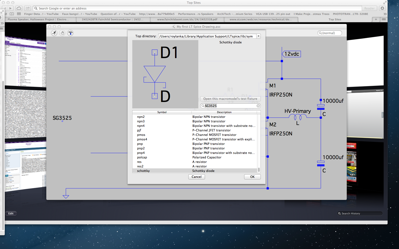

They should work. I always have trouble getting them in the correct directory and named right. Do you mean you can't insert the symbol into your schematic?
I chose draft, on right click and then go to the component listing. Not there.
Draft? I don't know draft. You should be able to click on the little "and" gate and see the component listing. What directory did you save the symbol in?
It's probably a little different on a Mac, once I have the component finder open it's not there?
But, I can click on it in the file inside LT Spice directory and it opens just fine, weird.

I probably have it in the wrong directory. Maybe I should remove all instances of it and then re-download and install without any changes. Allowing all content to be directed to it's current file location.
I think I may have screwed with it during installation.
I'll give that a go and get back to you.
I reinstalled and it's the same thing. Cleared out everything. I'm sure it's in the wrong directory. But, I just don't know how to put in the right one. If I follow that file path in the 2nd pic, their is no Application Support/Path.
However, if I go directly to my applications folder and right click and open package contents, it goes Contents/Library/cmp,sub or sym. this path allows me to paste into it.
It should be like in the above caption 2 pic, which is....
/Users/roylanka/Library/Application Support/LTspice/lib/sym and (not) below.
Application/Contents/Library/sym or sub
I think I need to figure out how to copy into the correct directory.
Thanks, ronv.
Ok, I know what's wrong, Mac's by default will hide Library, it began in Lion. The only way to show it is to, Press and Hold the Option key and in Finder click Go, it will drop down and show Library, if you release the key it will appear. I'll have to work on it tonight.
I just needed three more parts to the original circuit 2-12v Zeners which are back to back between source and drain on my IRFP250n, their powering a Flyback, nasty kickback protection from what the author say's.
MPK non-polar cap for similar reasons a bit of isolation from the GDT driving the Mofets and then the SG3525 driver. Here's the original Schematic.
