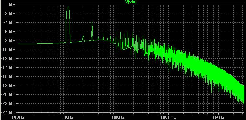

I am designing an audio amplifier with LT SPICE. If I do an FFT of the output, I get a lot of harmonics appearing. Lo-Fi you might say..
However, if I disconnect the sinewave input and put a probe on the (completely unloaded) sinewave output, I still get the same harmonic content (second and third harmonics especially, but lots of high order harmonics up in the MHz region).
Any idea what I am doing wrong? Surely i should just get a single spur at 1kHz for a 1kHz input, or has theory changed since I leant it all....?

Thanks for this, but in SPICE the input impedance of the probe should not matter. Essentially what I have done is disconnect the amplifier from the source signal and all I am doing is measuring the source FFT.
This should be a perfect sinewave - it is SPICE.
To answer your questions, my input is 0dB (obviously), my second harmonic is -70dB, my 3rd harmonic is -40dB.
Picture is attached.
Again, I would expect, in a theoretically perfect system (which SPICE is meant to replicate) that a sinewave just gives a spur at the fundamental.
I cannot measure the distortion of an amplifier if my 'perfect' sinewave input has got harmonics.....

You have to suppress the compression of the output data points that LTSpice normally does to make the RAW file smaller. Doing so will generate a huge RAW file. You may want to also turn off the data saving for all nodes and currents, and only save the ones you really want to look at.

He is measuring the source, not "stages".
You can reduce the apparent harmonic distortion by setting the maximum timestep to a tiny fraction of the period. This will increase your simulation time. I tried 100ns timestep on 1kHz and got 3rd harmonic distortion down to about -60dB.
Also, add the directive ".options plotwinsize=0" to the schematic. That drops all harmonics below -170db. Also, make sure that the FFT is taken on whole cycles of the sine wave...
