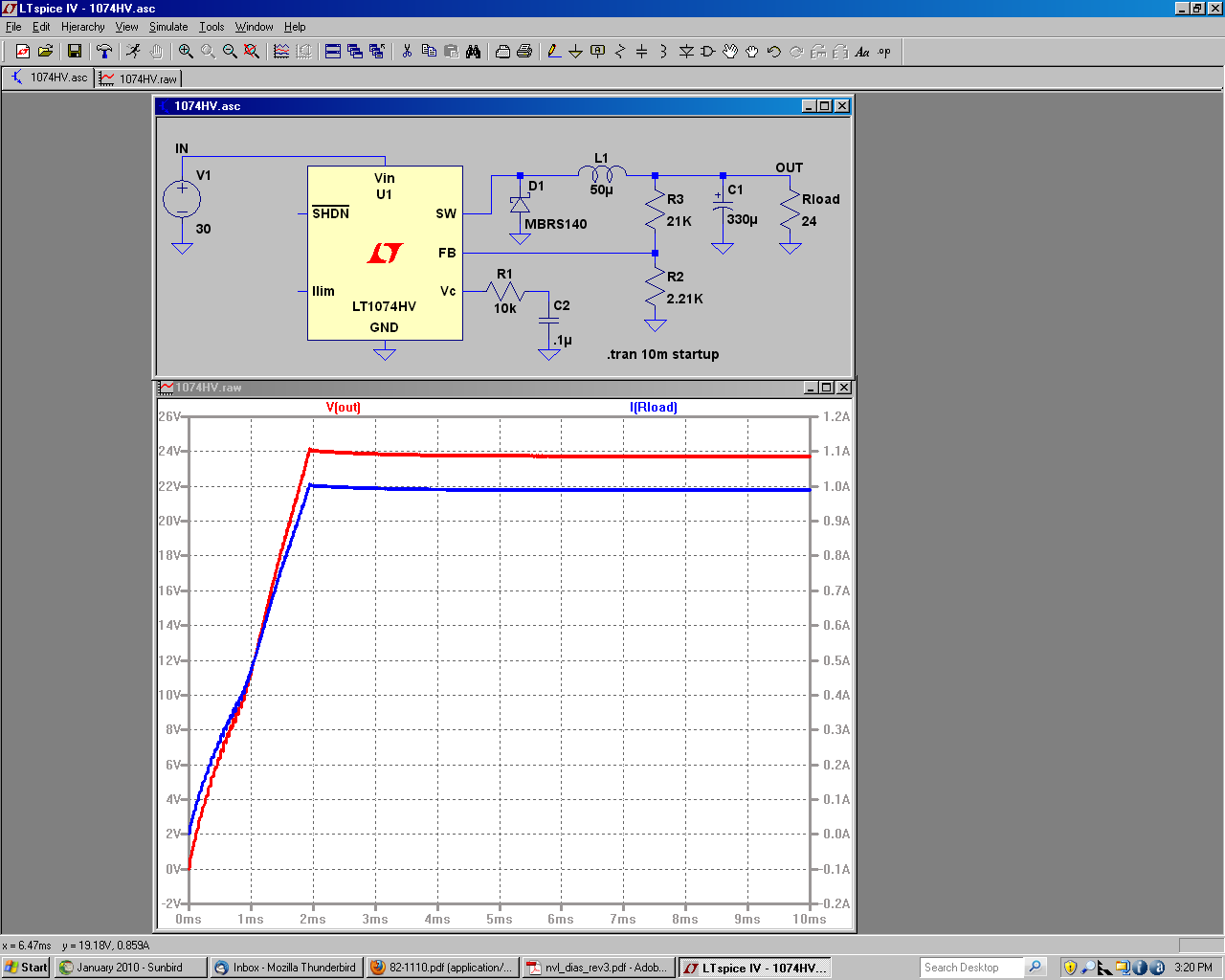

What is your input voltage?
Also, I ran a simulation, and the output ripple was about 0.5Vp-p at about 3kHz. Can you tolerate this?

Go over the datasheet again and look for the example circuit. Almost all 'adjustable' switching regulators have a 'FB' (feedback) pin, which is used to set the output voltage via a voltage divider. I tihnk the datasheet even gives you the formula for working out the resistor values for a given output voltage. The chip will try to keep the votlage at the feedback pin at 2.21V (according to the datasheet), so, you need to make a resistor deivider which can produce 2.21V, from 24V (your output). Google is your friend :D
What is the unregulated input voltage?
