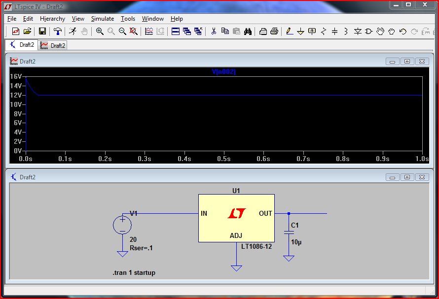

Was just going to play around in LTspice with a linear regulator, dropped a few components and immediately got an unexpected result. It's a 12 volt regulator model (supplied directly from linear) I was surprised to see the intial voltage spikes to 16 volts, granted the output is unloaded. Using a large output cap starts eating the voltage peak and applying a load does as well. I'm using the startup directive which means it starts at 0 volts and goes to 20 volts in 20us. Do real world linear regulators do this as well? Can anyone shed some light on the responce?

It's likely that that closely approximates the operation of the real regulator. The regulator takes a finite time for it's circuits to settle to the final value. During that time there can be a small overshoot in the output. But in a real system with an output capacitor and load that should not be a problem

I expected some overshoot, but unloaded it's 4 volts over the output. Unloaded the over voltage lasts 20ms, loaded with a 100ohm resistor it's like 80µs and a volt lower. Bigger caps almost completly squash it. Live and learn I guess. Nice to see a simulator showing close to real world results

Actually, nevermind my last post. It's a simulation artifact. You've got it set to start all voltage sources at zero with the 'startup' in the sim command. If you make the voltage source a pulse that has a 10ms ramp from 0 to 20V and then stay at 20V for indefinitely long (on time for the pulse longer than your sim time) you will see it goes away and all you get is a very small amount of ringing as the reg turns on. It also goes away if you simply delete the startup command and have the external source start at 20 and stay there. The spike is just an artifact from the voltage source starting at zero and going to 20 in almost zero time flat. Even just a 1ms ramp time is enough to keep the turn on spike below 0.1V.
I'm using the startup command, it's defaulted to 10us though. I"m curious though when you flick a switch on a real circuit what does the regulator actually see? If it's a switch I'm sure it's noisy, if it's a switch powering a transistor that actually turns the regulator on, I'm guessing it's a pretty sharp turn on.
True, if it's a semiconductor switch then it becomes worrisome if that is truly the real-world result and not a simulation artifact. So much is going to depend on input capacitance, trace inductance, parasitics, etc that it would be hard to say what it would look like in the real world. But you're right, it could be something to worry about.I usually have so much bulk capacitance on the input side for filtering that I guess I never really thought of it.

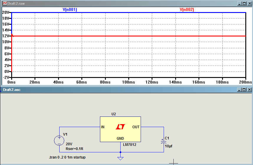

If you replace the Vreg with a 7812, the excessive overshoot disappears.
RB,
tried the input cap [10uF] in the original circuit, no effect.
Suggests, the 'overshoot' is an artifact of the LT1086-12 model.

I did that in a number of runs using the 7812, never got the 16V long overshoot that SC saw.
Also tried various load and current plots, again, nothing as high as SC.
I believe is a problem in that LT1086 model.
If you have LTS I could post the *asc.:)
The startup spike could be an artifact of the model, or it could be an accurate representation of actual performance. Hardware is the only way to know for sure.
