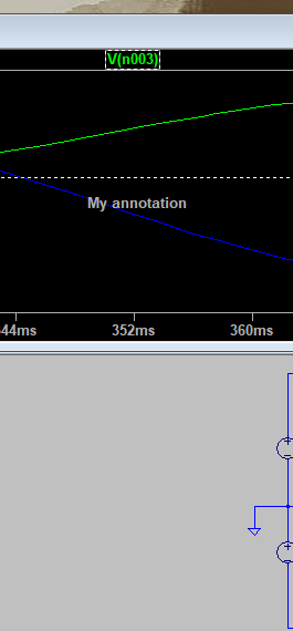

If this is what you got,
By right clicking on the pane, the DRAW option allows text and some graphic tools.
No. I know how to do it manually.
This annotation came up with the the value at a specific spot on the trace, sort of like this (which I did manually).

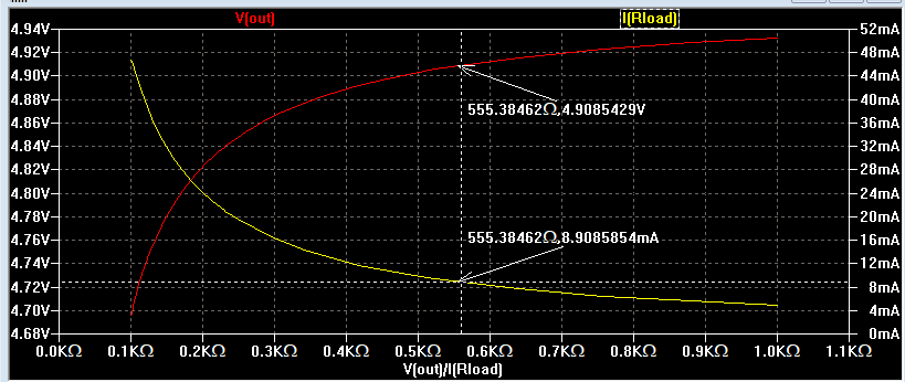

In LTspice IV you go to Plot Settings/Notes & Annotations for the Label Curs. Pos. command.
Here's an example plot with the annotations:
It doesn't have a box around the data as I misremembered. :oops:
Hooray! :D
Thanks, eTech, that does what I was asking about.
