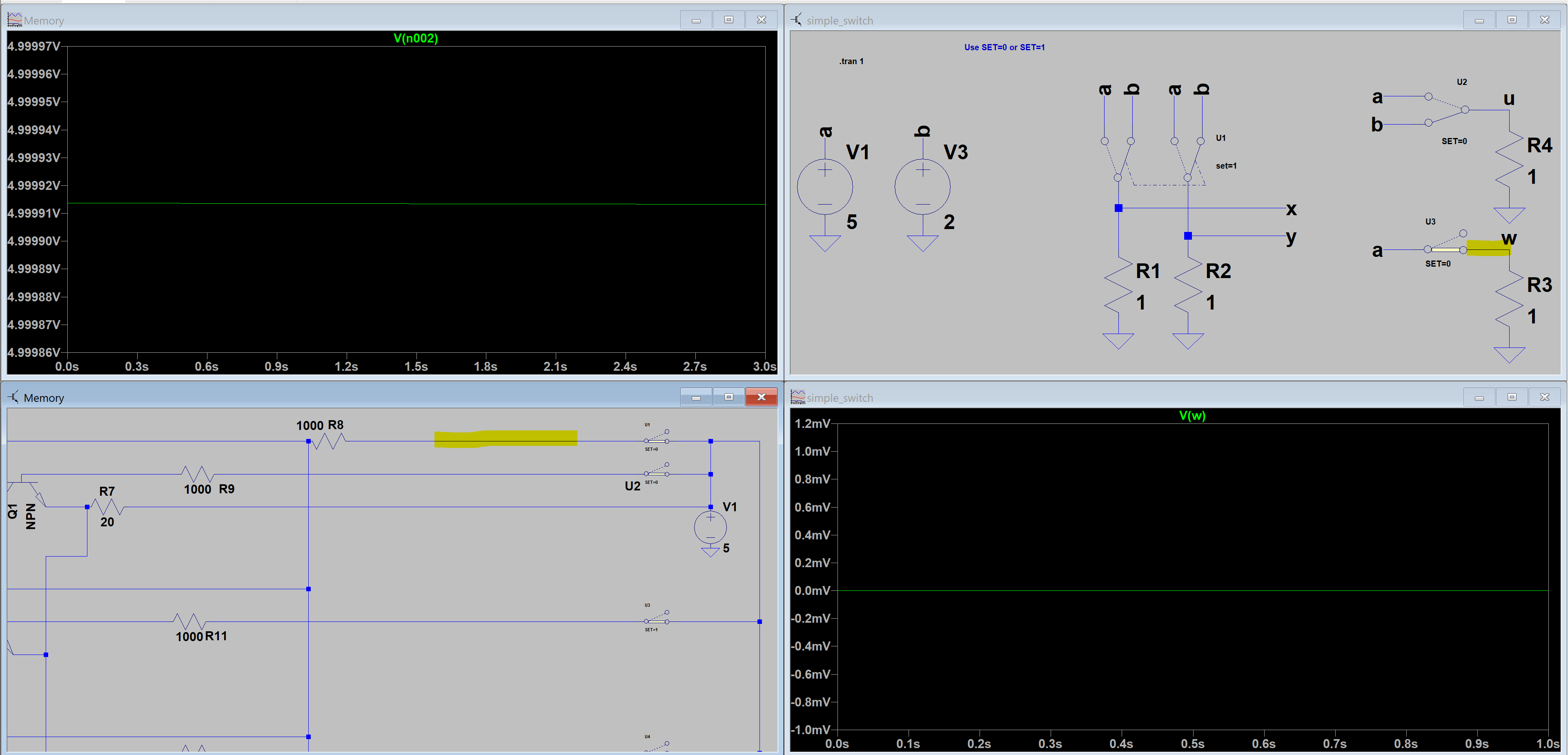

Hi
In the picture bellow I am probing the highlighted wire in simple_switch schematic (from yahoo group). The current and voltage through that wire is 0. I am also probing the highlighted wire in my custom circuit memory. But for some reason memory's voltage is 5. Not sure why that is happening. Both switches are set to 0 witch means off (or open). Hence the memory wire shouldn't be getting any voltage or current. I would appreciate any help.
The image is too large, and the parts too spread out to readily follow the circuit.
Move the parts together, with less empty space and post a smaller picture.
Also post the .asc file.
Do you have a ".param set=1" directive anywhere on the schematic?

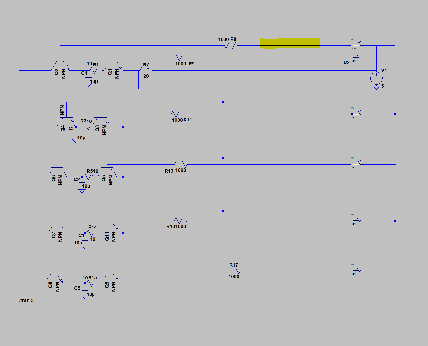

Hi
The image bellow is the whole memory circuit. I have highlighted the wire that has voltage when the switch is off.

Hi
Attached the .asc file to this post. Switch u1 and u2 are causing the error.
Thank you
  • ascfile.zip
How can that be the whole circuit, there's no connections to the transistor collectors?
Leakage current through the base-emitter junctions is causing the effects you're seeing. Add pull-down resistors to the base connections.
