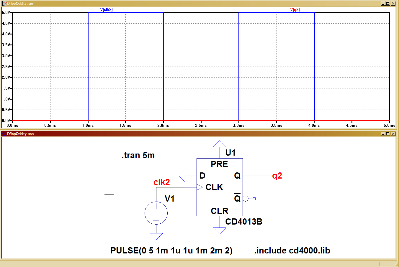

hi Alec,
Confirmed that model is suspect, I would recommend that you use the digital IC libs in future.
Modified asc attached.

Thanks guys. Nice to know I've not lost the plot entirely!
Do you know of any legit way of downloading CD4000.lib without joining the Yahoo user group? (I'm not a fan of Yahoo!!).

I dont know another legit way.
Why not bite the bullet and sign up with the yahoo user group, your design life will be much easier...;)
Thanks, guys. CD4000.lib now installed.
Thanks Eric, I'll look into that.
Another oddity (to me anyway): when I placed the CD4000.lib file in the 'lib' folder (which seemed the logical thing to do) LTS couldn't find it! So I moved it into the 'sub' folder and that's OK.
