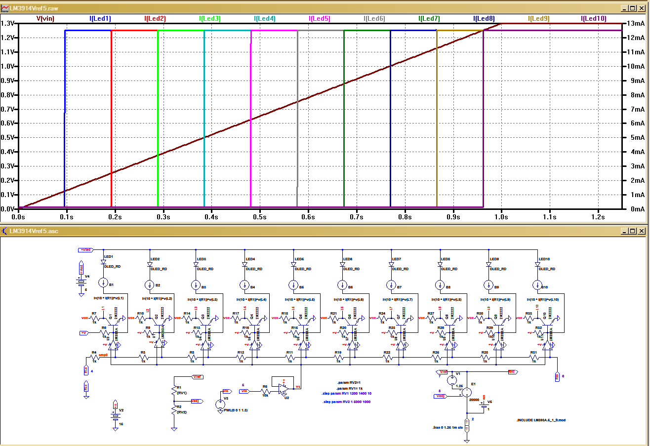

I've checked the Yahoo user group but can't find a model of the LM3914 for use with LTS. Anyone know of one?

This is a WIP LM3914 that I have been working on, you could finish off and make into a Hierarchical LM3914 model.

Thanks for that, Eric. The model I created for the thread 'Fuel Gauge Adapter' uses behavioural current sources instead of op-amps plus transistors. It will be interesting to compare the performance of the two models (one day!).
