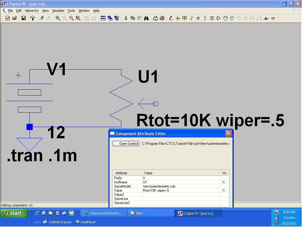

I have a folder named new in both the sub and sym folders. I put the symbol in the new symbol folder as an .asy file and the subcircuit in the new sub file as a .sub file. I then changed the Spice model line to point at the sub file.
I seem to have a mental block about this. Don't know why.

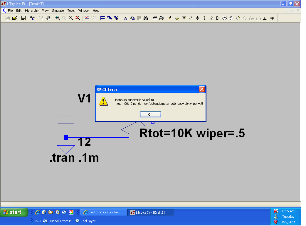

Could I be putting it to far down? I am using like your option b. except my path is lib, sub, new, potentiometer.
When I try to run your asc. I modify the include directive to new/potentiometer.sub, but no dice. I get unknown subcircuit called.

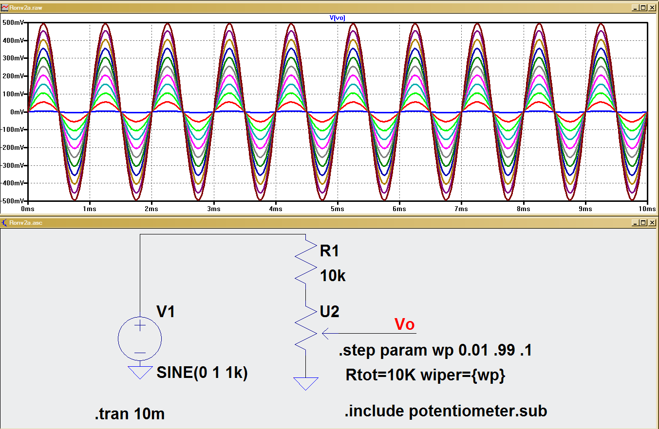

I put the sym in the main symbol file and the sub in the main sub file and away it went (with includes). Is it possible to step the pot with time? It would be neat for example if you could see the output of an amplifier change as the pot changed.

hi Ron,
This is one option.
EDIT:
Download this free audio program, use the 'Generate' option to create 'chirp' wave files.
You can change the start/stop freq, amplitude, waveform type and the time period.
Export the file as a 'wav' file
Use the LTS 'wave' option to drive the 'chirp' waveforms into your audio amp simulations.
http://audacity.sourceforge.net/
