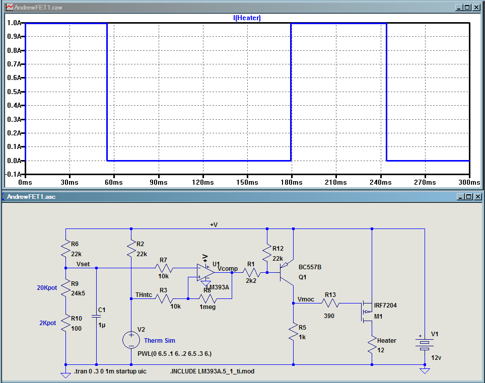

I have a circuit that worked, I am now trying to insert a SCR in the place of a Opto and Triac, thats when the message comes up.
All to the left of R13 works but I want to switch a 12V d.c. load of about 50W.

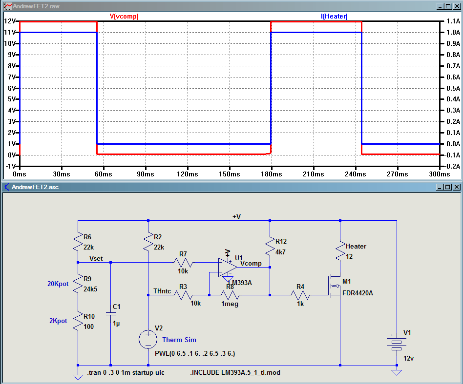

You can switch ON an SCR to control 'dc', BUT you cannot switch it OFF without removing the load connection to the SCR or shorting the SCR out.
Switching 'dc', no ZCD is required , so no MOC is required.
Use a power MOSFET not an SCR.
OK progress. Used an N channel Mosfet and the circuit switches but out of phase I think. Heater appears on when it should be off?
Tried a P channels Mosfet and it never turns off.
Why would the current be a negative value?

Look at this P MOS option.
  • AndrewFET1.asc

This a N MOSFET option.
  • AndrewFET2.asc
