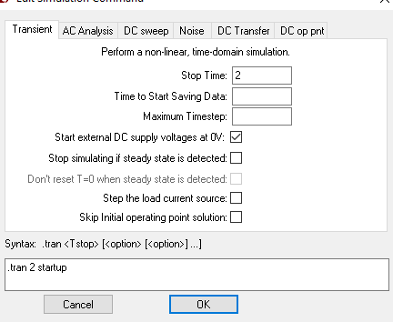

I don't know what the LTspice trying to show me. In Transient, if I set 2 second stop time, the osc (voltage booster) showing nothing boosted (just showing around 8V which is its supply voltage). If I set 2 mili-second stop time without changing any parts then I can see the boosted output of more than 20 volts. WHAT I should understand ?
(I made the osc in real world. When I measured output with my DMM, it whows 18V just first half a second then starts to show 8V. Maybe it has high impedance output which cannot drive my DMM?)

You've run into a common problem with oscillator simulations.
Circuits with oscillators sometime will not start or start erratically in simulation, since the circuit normally does a DC analysis at the start, and this can put the oscillator in a quasi-stable, non-oscillatory state with no intrinsic noise to start it.
Check the voltage startup at 0V box or the Skip initial operating point box in the transient analysis which eliminates the initial DC analysis and usually starts the oscillator.

Hi, Thank you! It worked! But with 2 second stop time, it took me tens of minutes to simulate 100%. Is it normal?
Yes.
Simulating a high frequency circuit for a long period of time requires a zillion (estimate) calculations which takes a lot of time, even with a modern PC.
My laptop takes about a minute to do 2ms of simulation, so 2 seconds sim time would take about 17 minutes real time.
I measured an oscillator frequency of about 1MHz so for 2s, that's 2 million cycles.
So it calculates about 33 oscillator cycles per real-time second.
And each cycle takes many floating-point calculations.
