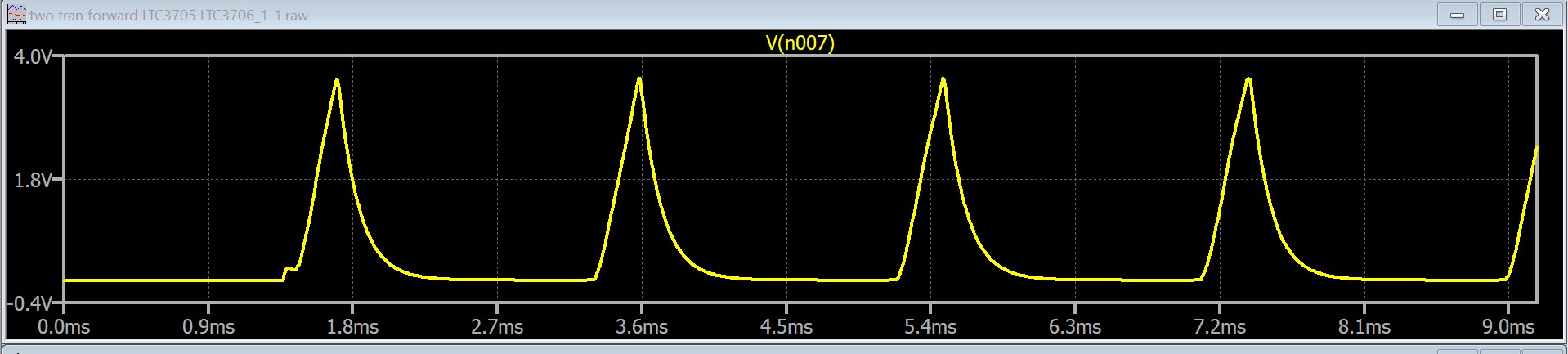

This is what I'm seeing at what I assume is the output :-
Is that what you expect? What do you mean by 'not working'?

I suggest you divide the circuit into manageable chunks, sim each chunk separately and hope to identify the chunk that's causing the problem.
usually if LTSpice has trouble establishing a stable operating point (errors are usually "time step too small, singularity matrix node(node-name)", or veeeeeery slooooow operation, it's because there's something causing the circuit to be unstable, such as positive feedback connected somewhere that expects negative feedback.
