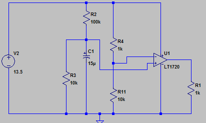

I am new to using LTspice and I have built a simple circuit to analyze the charging of a capacitor as input to a comparator.
It seems as though the LTspice program only takes into the account the voltage after its charged. I re-simulated using an since wave and got the desired results.
This brings the question, how do I run a simulation where I can analyze the change in DC state of the cap charging?

Posting image maybe.
Was trying different values of resistor/cap combo, but couldn't get it to simulate so these are not the values im actually using.
Great I posted wrong image too :p
correct image

That image is fine...
I think that you can also save the LT Spice file, to a known location .... and load it as an attachment.
Have not actually tried it, but it ought to work.
This would allow simulation.
After you have run the simulation you should be able to click on the junction of R2,C1 to see the voltage from the start.

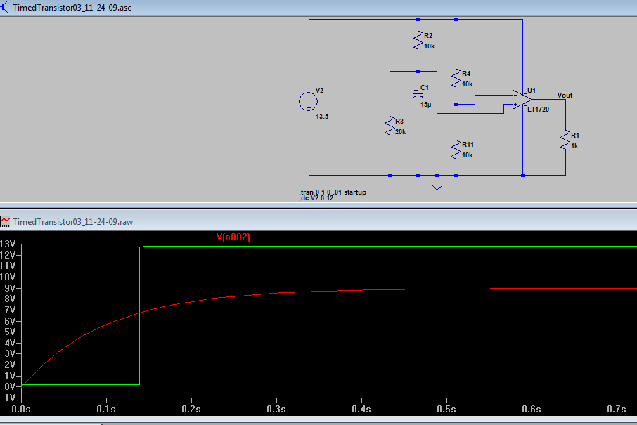

Ok i resolved my issue. lol
I miss read the voltage divider of my actual circuit i had built. So now that
I changed it its, correct.

Regarding your initial question ....
It looks like the startup specification, under simulation commands, is necessary to get the correct transient graphs, otherwise LT Spice assumes that everything is steady-state.
.... Something having to do with initial conditions, apparently.
One item to investigate within your circuit would be the reference voltage value.
This would adjusted by changing the ratio of R1/R11, as shown in your circuit.
In some op-amps, as the magnitude of the input voltage value approaches the rail, or supply voltage, the op-amp will cease to function properly.
The idea would be to determine how close you could bring the negative input voltage terminal to the rail voltage, and still have the comparator switch correctly.
