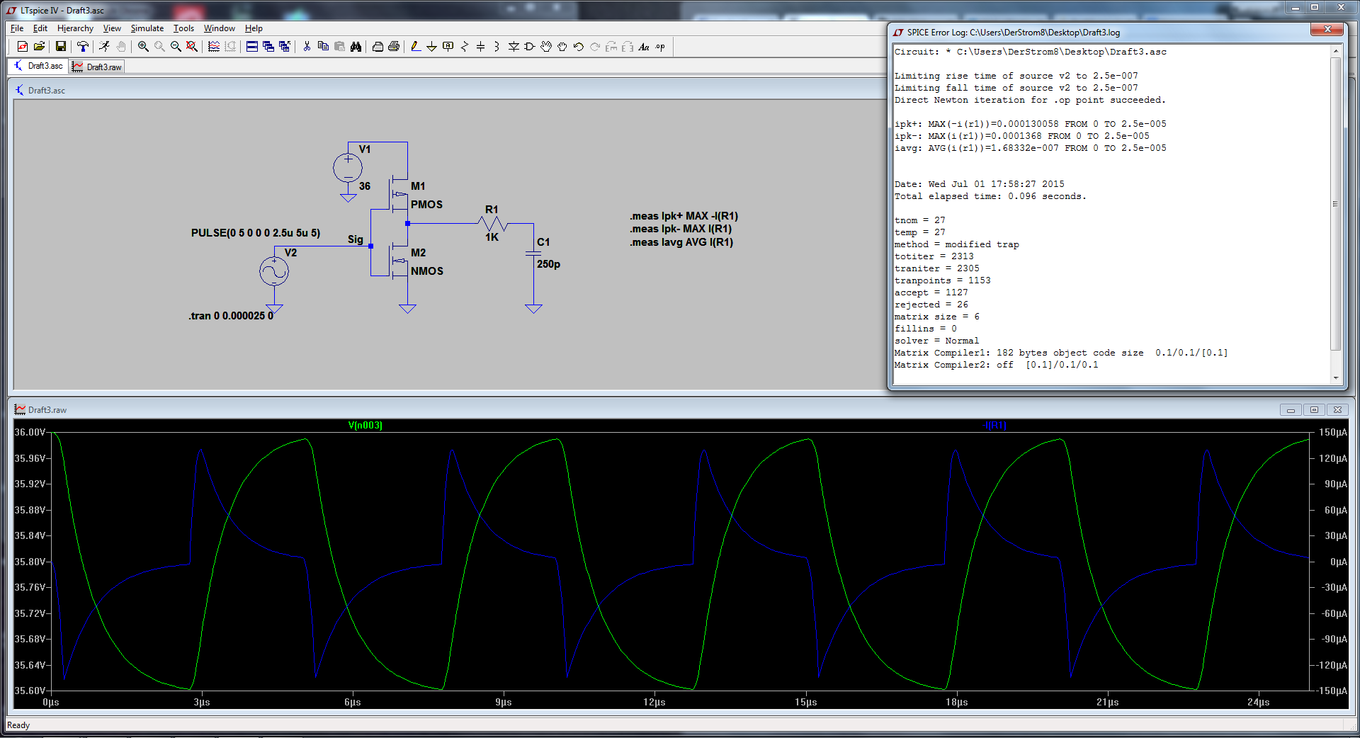

Hi all,
First of all I'm going to mention that I very rarely use LTSpice. Usually I use Multisim or Proteus.
I have the following project that was handed to me by another engineer at work. He was having trouble with it so he wanted me to give it a try.
(I am attaching the .asc file as well, for those of you who have LTSpice installed)
I am uncertain about the values I'm getting for Ipk (both + and -). I would expect Iavg to be close to zero (which it is).
Effectively I need to determine the peak current through R1 and calculate the power being dissipated by it so that we can decide which size to use in the new board design. I can't really go into detail on what it is, but you'll have to trust me that the circuit is correct.
V1 is a 36V DC power supply.
V2 is a 200kHz square wave with a 5V amplitude. I do not have any information about the rise/fall times, so I am assuming a perfect square wave.
The two MOSFETs are representing the output stage of a Microchip HV574 (**broken link removed**). I have left out the freewheel diodes.
Can anyone spot any mistakes? The values I'm looking for are:
Ipk(+)(R1)
Ipk(-)(R1)
Iavg(R1)
P(r1)
Thanks folks!
Matt

The voltage the input is referenced should be 5V (VDD), not the 36V you have shown. With your circuit, the top P-FET will always be strongly on.
If you just want to emulate the output driving the RC, then change the input pulse voltage to swing between 0 and 36V (or just omit the FETs and use a 0/36V pulse as the driver).

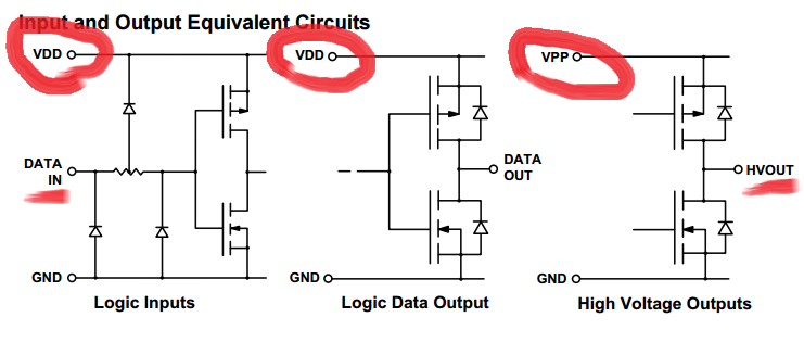

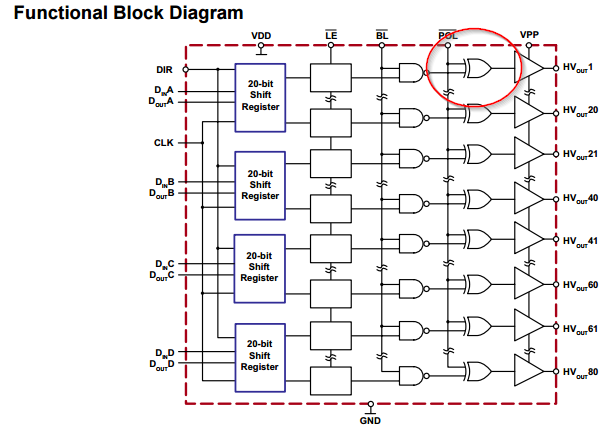

Once again the FETs are not discrete, they are the output stage of the HV574. The 5V source may be my issue. I'm not sure how the output stage is driven. I do know that there is 36V on the drain of M1 (the P-MOSFET).
Not at the input stage there isn't. Have a look at the datasheet (excerpt below). VDD is 5V, VPP can be more.
Ahh, I was looking at the wrong one. The 36V is indeed for VPP. I guess the question now is, how are the high voltage output FETs driven? I see one XOR gate going in, but the FETs appear to have separate gates (according to the HV output stage diagram):
They'll be driven with a separate driver for the high-side and low-side FETs. The gate voltage of each might only swing 5V to turn each on (they couldn't handle the full VPP across the gate). You don't actually need to know this if you just want to find the current and power in R1 (I addressed this in my first post).
I must admit, I'm a bit embarrassed about this. I knew they were high-side/low-side FETs and would require separate drivers, but my mind just went the opposite direction :p

M1 is connected upside down; the source should be connected to +36V, not the drain. As it is, it's simply conducting through the substrate diode, which is why you're getting that flakey voltage on your output.
Also, M1 needs its own drive circuit with appropriate voltage levels (+36V and +31V relative to ground).
Once again, I did not design this circuit. It is the output stage of the HV574. It is not connected upside-down (unless, of course, the datasheet is wrong)
No, the datasheet shows the correct connection. Look closely at how the P-channel FET's source is connected to Vpp. Your co-worker has the drain going to Vpp instead.
Wow, I don't know how I missed that! No wonder he couldn't figure it out! :p
