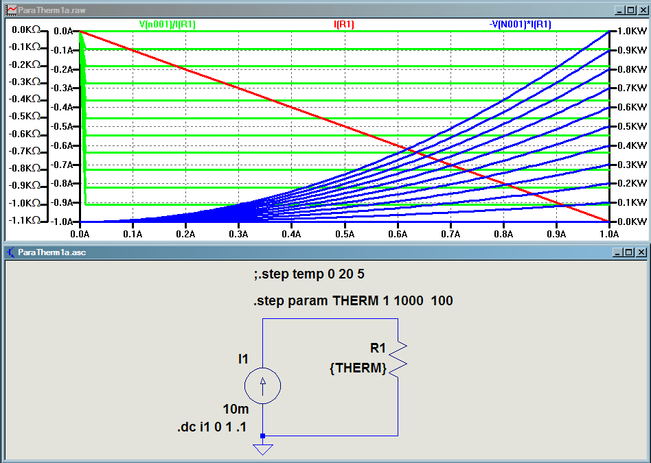

hi t,
Is this what you are asking.?:)
  • ParaTherm1a.asc
hi t,
Another example.
Click RUN, place the cursor on the load resistor so that the meter icon is displayed and press the ALT key to show a thermometer icon.

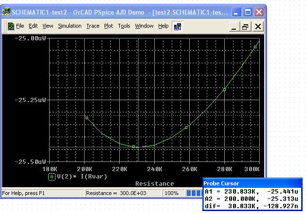

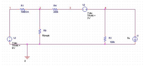

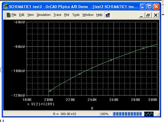

actually what i was thinking is this (if i'm right, ok?);
looking at the circuit below, RL (or R9) will dissipate maximum power when equals to thervenin resistance( which equals 230.8k if i'm correct).
i was expecting power to increase till R9= 230.8k then decrease afterwards.
am i right? if yes, why isn't the case here looking at the plot.

hi, eric
i think i've got it.
i've created RL as a global parameter.
isn't what i should expect?
