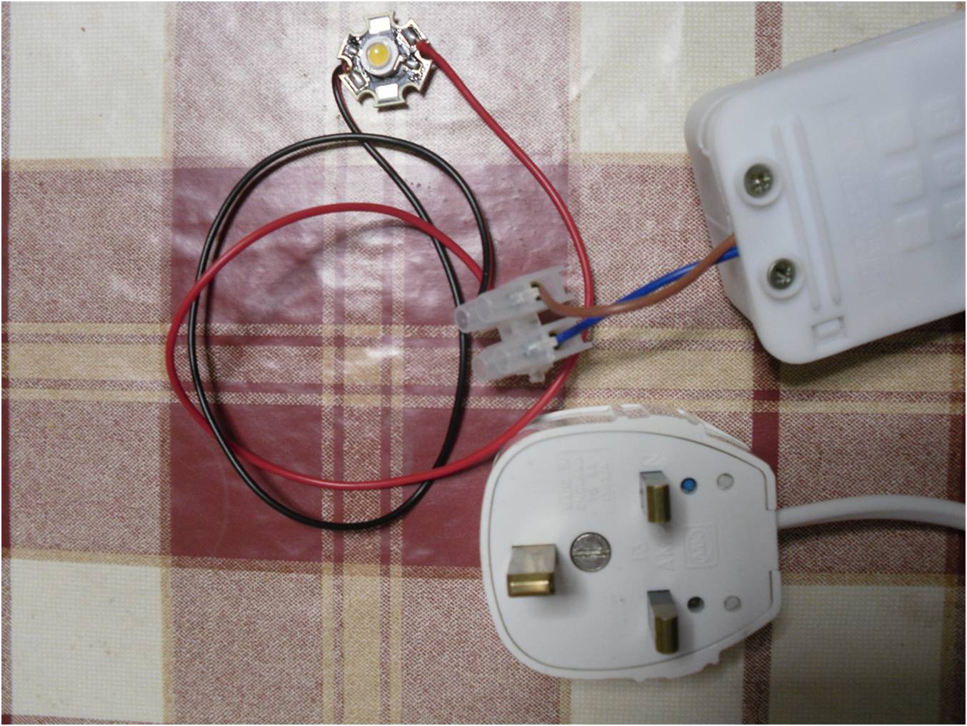

I want to illuminate two luxeon stars from the one plug, i wanted to know how it could be done and if theres anything i need to know .Ive attached an image of the luxeon star wiring. Is it as simple as breaking the wiring and attaching the other luxeon wires to it?

Depends on if the current regulation is on that little PCB or in the module itself, I'm gonna guess it's in the module which means if you put them in parallel you're going to get two half bright LED's, and it probably doesn't have enough voltage to run two in series, but you can try. Mind you your might hurt the power supply if it's not rated for the added power.
Try parallel first, just keep in mind the brightness will drop (but not 50% because light output vs current on an LED isn't linear) ideally it would be best if they were in series, but if the power module can't provide the voltage neither of them will light at all.
erm ok, the luxeon stars im using are 3watt, the fuse in the plug is 13amps, im a little confused as to how i would connect it in series, any help? thanks
Wait what? 13 amps for a 3watt LED? That can't be right. Given a loaded diode forward voltage of 4 volts you'll get 3 watts of power at less than an amp of current. Where are you getting 13 amp fuse rating from? To wire them in series you would connect the red wire of one module to the power supply + lead, the black wire on that module would be connected to the red wire on the second module, and that modules black wire would go to the - lead on the power supply.
Again that probably won't work. Run them in parllel (both red and black wires going to the same point on the power supply) and you'll likley get dimmer LED's. I want to know what's limiting the current to your modules though.

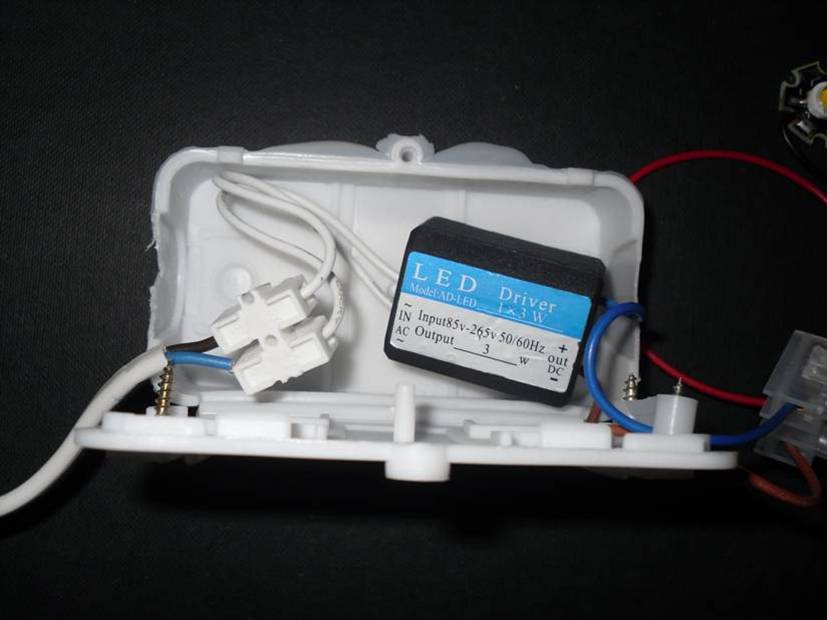

Ive attached the image of the transformer inside the choc box, does this make connecting the LED in parralel any easier?

You didn't answer the question Spatel, what are you using as a power supply?
LED's are nothing more than diodes that emit light, as soon as their forward voltage is reached they go from conducting no current to a LOT of current very very fast like within a few tenths of a volt, something has to limit that current, or the diode will self destruct. How are you accomplishing this?
isnt the plug the power supply? and isnt that black box the thing preventing it from running too much current? im not tottaly sure
Ahh, pictures speak volumes =) Problem is that LED driver is a little black box, can't figure anything out if you don't have the data sheet for it. Connecting them in parallel with that box would not work, even with ballast resistors you'd end up with two half bright LED's. You could try them in series but that supply isn't rated for it, no telling what would happen. Where did you buy the LED regulator from? Can you open the black box?
That datasheet can't be for the module you've shown, the input on the module in your photo has a wide range AC input which means it's a universal switch mode supply of some kind, the module in the PDF you supplied is for a buck/boost DC-DC converter.
You could simply try putting them in series and see what happens but it may damage the driver module, or simply not work, or it could work fine. Watch out for melting plastic though... and catastrophic failure of the current limiter would kill both LED's.
Your datasheet is for a different LED driver that operates from a battery, not from 230VAC.
Yours is designed to light a single 3W LED. If you connect two LEDs in parallel then the LED driver might smoke and burn. It probably will not light two LEDs in series and its internal circuit might burn out.
