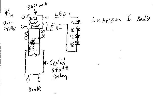

I will be replacing the twin 1157's (28 watts a peice) i have in my tail light with leds. I figure luxeons would be the best bet. i will be using the stock lense, which has some optics built in. I will also be adding in a difuser, or maybe coating the luxeon lense with a simi transparent silicone to smooth out hotspots.
that is the schematic so far. I am familiar with relays, but would rather use a solid state relay, as speed and reliablity are most inportant. Can anyone give me any pointers on them, since i have never used one b4. the reference from the buckpuck is 5V, the volt drop from the buck is @2v. lux I's in red like 110-350mA and 2.3-3.5v forward.
I will post pics of completed project.
