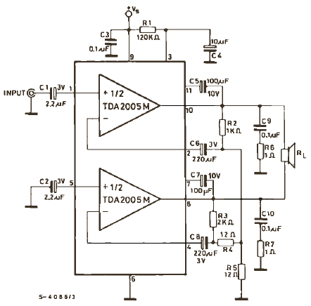

With a 12V supply and a 4 ohm speaker its output is 11W, not 20W.
If you connected the polarity of the power supply backwards then the TDA2005 IC is destroyed. the schematic on the datasheet is fuzzy but shows the positive pin is pin 9.

ok sorry . um anyways i didnt use that data sheet or the design . and im looking for any shorts right now and cant find any. can you point me in the direction by telling me were a short could be that its making that sound and heating up alot? and only one of the sides work without buzzing
The TDA2005 probably will not work if you don't use the schematic in its datasheet and don't use the pcb design shown in its datasheet.

OK this is a new update i got the amp to work on a 9 volt battery but i want to do it from a power supply fro the wall. i made a full wave rectifier with 4 diodes and tried different ways of making it and apparently the current is now dc so its working but theres still a buzzing noise when i conect it. when i have the battery in it doesn't buzz at all plz help!
There must be a pretty big capacitor at the output of the rectifier to filter the pulses from the rectifier. 4700uf should work well.
