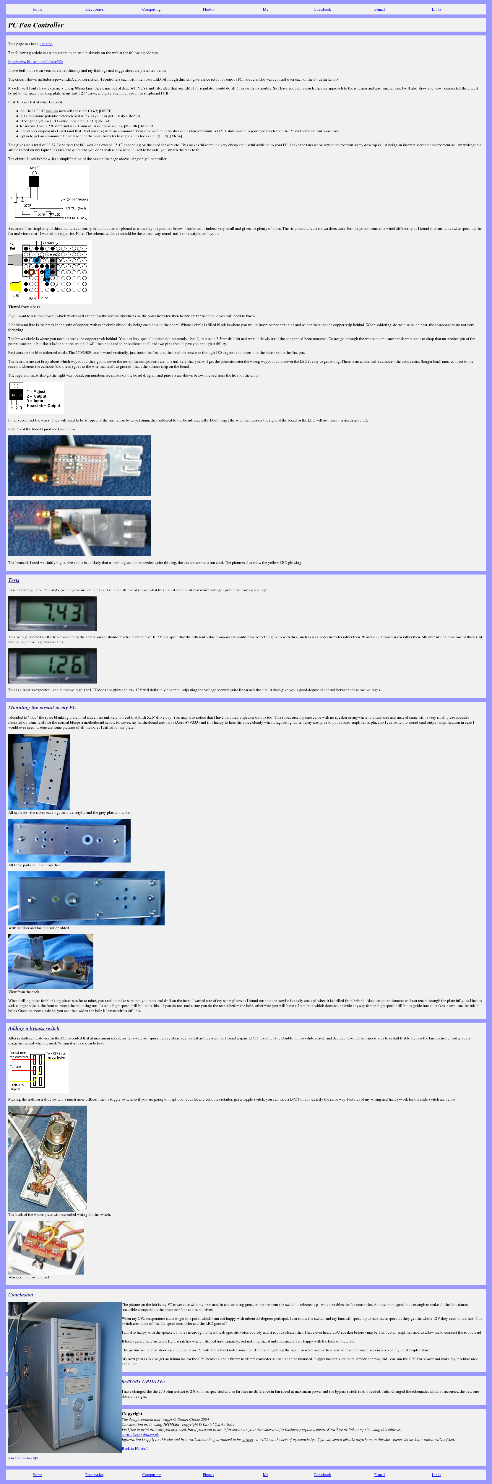

I am using a controller circuit I found on the internet and the motor is a 4-15V DC one from Maplin.co.uk. It has a 3000:1 reduction gear (NO1BQ) which they no longer stock but there is a NO4BQ. My motor looks exactly like their WC70M which is only 10:1. Perhaps you can find a suitable motor elsewhere if 10:1 won't do.
I use a DPDT momentary switch for forward/reverse. The potentiometer sets the speed from very fast to stop.
My magnetic loop (8' diameter 22mm copper tube with 45 deg. elbows) uses a large vacuum capacitor and it's for 80m/40m.
The previous loop was 13' diameter 28mm copper tube blew down in high winds and smashed the vacuum capacitor but I'm planning to erect it again. All my 80m contacts between UK and USA were made with this loop.
You have to expand the thumbnail in order to see the full picture.
