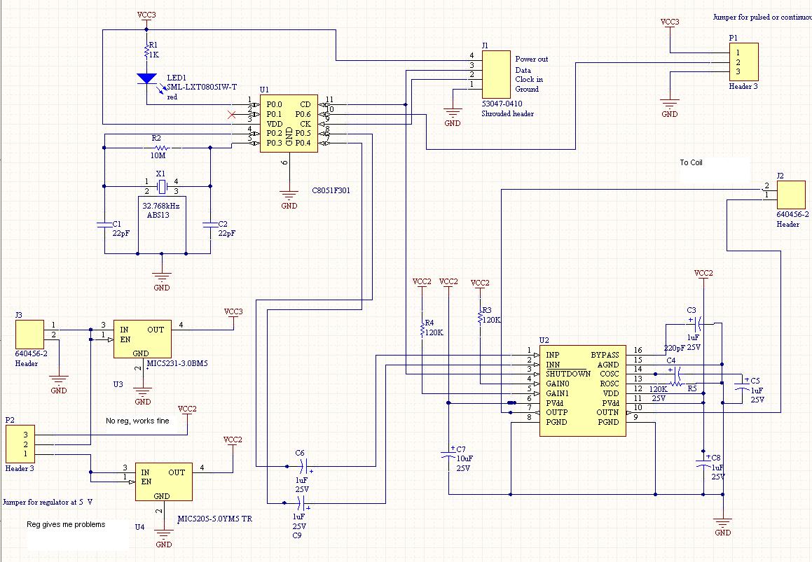

Hi everyone,
I made a circuit composed of a class d amplifier driving a magnetic coil that pulses at 21 hz. It has a 3V battery as a power source. This works fine.
When I extend my design to have a 5V regulator, the magnetic pulses gets screwed up. I check the magnetic pulse outputs and it is distorted. The regulator output has spiked voltages in intervals. So I suspect having a regulator has something to do with this problem.
I tried putting a diode in series, output capacitors (up to 100uF) on the regulator, zener doide in parallel. All to no avail.
All I need to do is to make the regulator act like a battery. As with the battery I did not have any problems. Any suggestions?

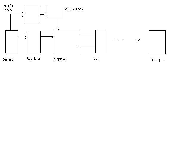

Its to track something. I followed the data sheets on it and it worked fine with the battery as a straight power source.
I uploaded a block diagram.

Try posting the schematic. Maybe someone will see something wrong that isn't apparent on the block diagram.
I don't see why you are having problems with the regulator, but it appears you are running digital signals into the analog inputs INP and INN. I don't see how you can get PWM this way. Are you not using PWM?

The TPA2000D1 is a pulse width modulator. It produces PWM at the output in response to analog signals at INP and INN.
I still don't know why your system doesn't work with a regulator. I would start by connecting 0.1uF caps from input and output of the regulator to ground. I would also connect a large cap (100uF or more) from the regulator output to ground.

In reference to my first post, I already did connect 100uF output cap. As for input I think I tried 1 uF cap. All it did was lessen the voltage spikes, but my receiver still received crap.
As for the analog input, does it matter whether it gets an analog signal (I'm assuming a sine wave) versus digital (square wave)? I think as long as there's an input the amplifier doesn't really care.
I thought about that at one point and built it anyway and it worked. I don't see any reason why a regulator would screw things up.

The datasheet for the TPA2001 shows that the load current is zero when the input is zero. See Fig. 10. Most voltage regulators have a minimum load requirement. Try putting a 470 ohm load (to GND) on your regulator and see if it fixes your problem.
MIC5207 or MIC 5205 has a no load stability which means it should work and remain stable with no load.
However I will give it a shot and let you know. Although even if it fixes it, since it will be extra power drain it will not really be a fix application wise. My application requires conserving battery life and making it pulse as long as possible.
