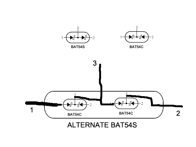

Maing a BAT54S from 2 BAT54C's
AtomSoft
Would this be possible ? I need a BAT54S but cant wait for it to come in. I have a ton of BAT54C tho. I have drawn a image.

As long as wire lengths aren't critical and you don't need thermal coupling, it should work OK.

I dont really see anything about that should be ok i assume... Ill try it and also make a PAD for the BAT54S so when it arrive i can simply cut 3 traces and use the single pad
