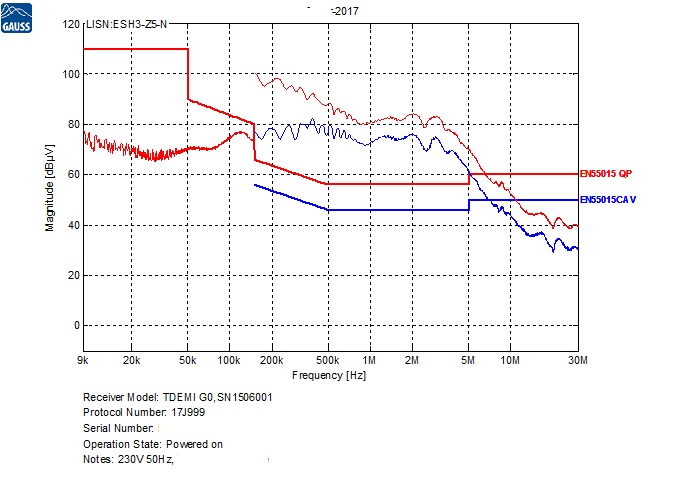

Thanks, i see your point, but even if its only extremely rough we need something, since we have failed mains EMC conducted emissions as per the attached EMC conducted scan.
We cannot understand why we have failed the EMC conducted test...because our led streetlight only switches 10 times per mains half cycle, and these are gentle switching transitions.

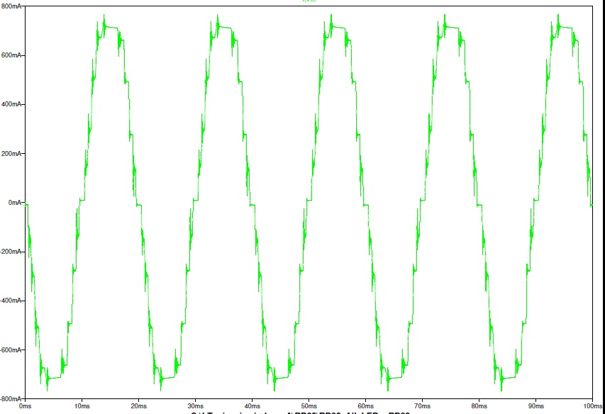

The mains input current to our product is as in the attached...as you can see, it shouldnt have failed this badly.

What exactly do you call gentle transitions? What I see are wild oscillations.

Surely the results of the test should point you in the right direction (by looking at where in the spectrum you where over the limit)? I'm afraid the plot that you posted means nothing to me, so I cant make any suggestions - although maybe others can. It's really impossible to tell from the current waveform what might be in there, given that the timebase is so low - you'd have to zoom in on one of those spikes and take a closer look.
If you can narrow down the frequency and whether you problem emission is common or differential mode then you have some idea what to look for with a scope connected to the LISN, even without a spectrum analyser. You should then be able to play around and see what circuit modifications reduce or increase those signals.

It would be nice if you would show only a single cycle of the waveform instead of five.
The EMI spectrum depends not so much on the number of transitions, but rather on their transition times. What are the rise and fall times of those "gentle" transitions? Show a scope capture of some of them.

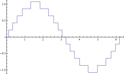

It looks like your waveform is a stepped approximation to a sine wave with 5 voltage levels per quarter cycle (not counting zero), with the ideal looking something like this:
Such a waveform has about 8 to 9 percent THD, probably exceeding the limits on the percentage of certain specific harmonics, such as 3rd, 5th, etc.
You may need to have more steps in the waveform.
Thanks, i attach one mains cycle here..

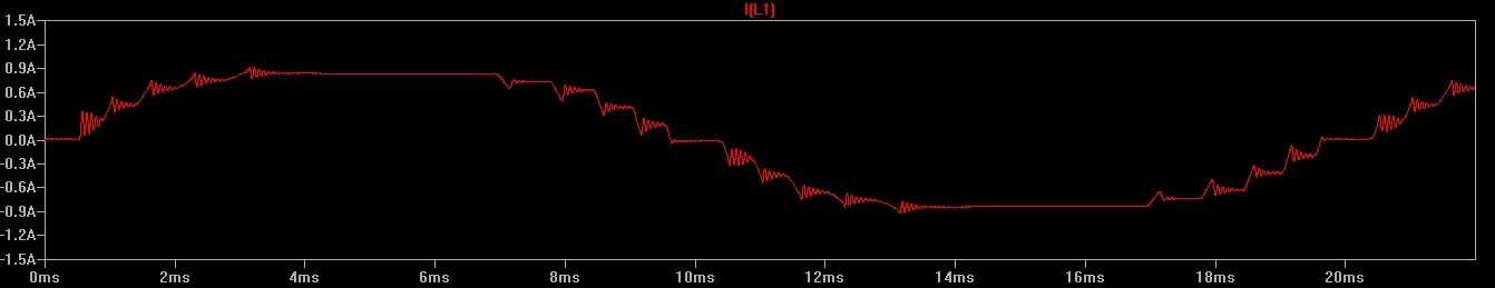

Example of mains input ringing current supplied attached

Another point is that because we dont have an SMPS, we can use iron cored input inductors and get 100mH with a small size.....then our mains input current waveform looks like the attached....and i am sure you would agree this isnt going to fail any mains harmonics whatsoever.

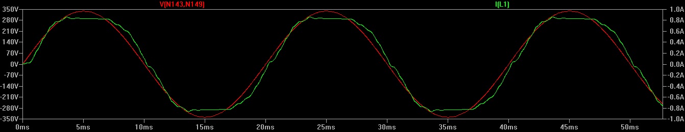

The waveforms in this image appear to be simulations rather than scope captures; is this the case? Have you got any scope captures?

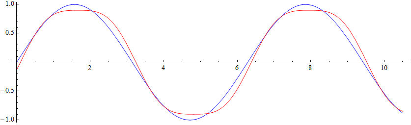

I think there is more distortion in the green waveform than you think.
Here's a plot of a pure sine wave (blue), and that same sine plus 10% 3rd harmonic (red). Notice how very similar to your green waveform this is:

What you say is of great interest. You are absolutely right, I ran the Fourier transform on the simulator and it comes out as just over 10% at the third harmonic. I then ran a confirming LTspice simulation, and it shows the waveform being just like ours when the third harmonic is set to 10% of the fundamental.

We do have scope shots but yes the ones I have here are from the simulation.
