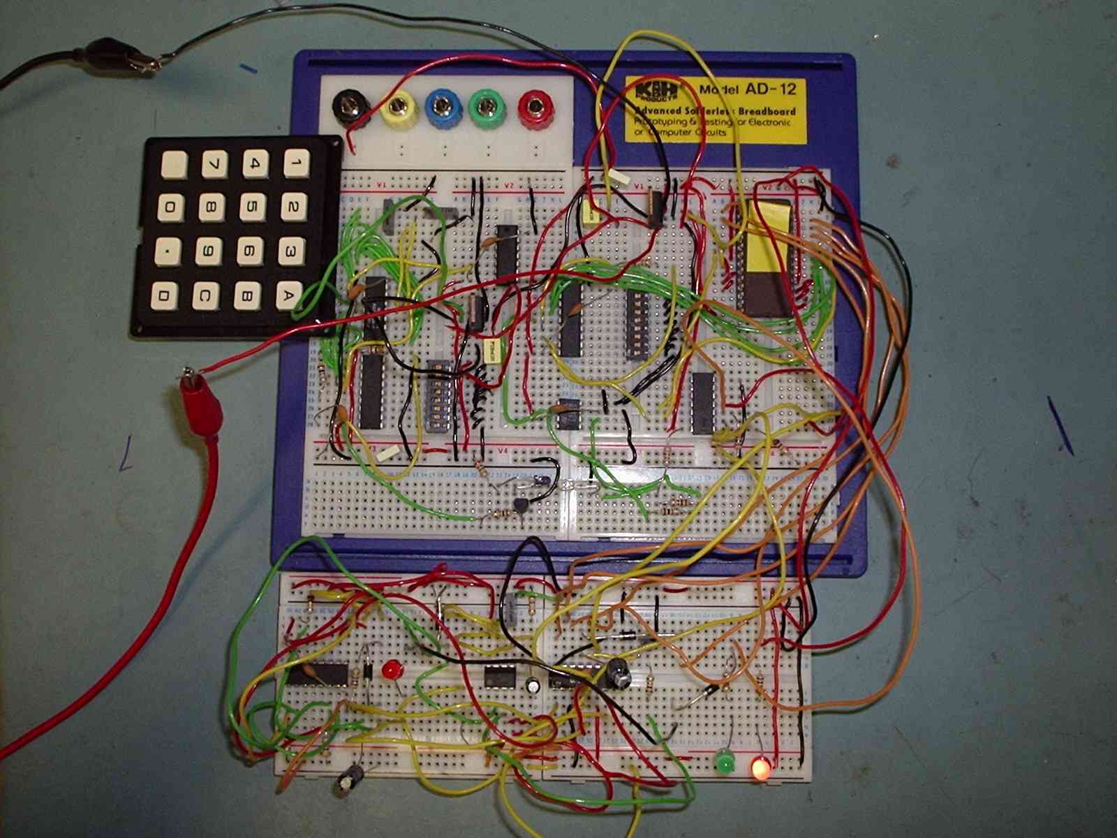

I've just completed my HND in electronics (a thanks to the people that put me in the right direction with my project - worked on bread board but unfortunately didn't work on pcb) and am moving on to further education.
The picture shows my project in it's working state - the idea was a code entry system combined with a infra red link - i.e. type in the right code and the system will grant access...... wrong code too many times and you'll be locked out......

I'm not familiar with the terminology , if I'm correct what you mean is the main feed to the house. The way to control that would require a contactor of high A (100+ A)
If You mean a single circuit the best way to interface your circuit with a single circuit the solution is an SSR -solid state relay- most have a 3-40v input and a 110-220V output with variable amperage.
The question of so many tries then Your lock is disabled, requires an incremental loop in one of the registers and a RTC to disable the numeric pad input for x time. Don't know what controller your using but if it it's a pic Nigel Goodwin ( a board contributer ) has a link to his site w/ tutorials for the pic series.
That's vastly over complicated! - if you check my PIC tutorials I give details of a combination lock, which (because it's just software) you could easily modify to lock out after a number of failed attempts (or any other facilities you wanted). It uses just one 18 pin PIC, and even has an LCD display so you can see what you're entering!
Yeah thanks for pointing out it's over complicated! I knew it could be done with 2 programmable (pics) chips (well thought that - think i did have a look at your site nigel in the early stages of my project when hunting down possible solutions) It was a learning experiance to use technology that I had learnt putting theory to the test, like the 555 etc... and perhaps my presentation was a little more interesting than explaining code perhaps.
Also I had no experiance with pics programming langauge so didn't feel I had enough time to learn the basics although it's something I'd like to look into. We learnt a simulated version of ASM and the building blocks to C++.
