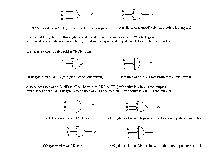

Forget the pull down resistors. The 74LS seies is TTL. A pull down resistor of will do nothing with TTL unless it is very low, ie. a few Ohms.
With TTL, an open input is equivalent to a high ie. a 1 in positive logic.
So how are you defining the inputs? ie. are you connecting them to +5 V for a High (H) and 0 V for a Low (L)?
Also, how is the LED connected to the output?
Is it between the output and 0 V or the output and +5 V?
Truth tables for gates and other types of digital logic are best written with H and L rather than 1 & 0 since in positive logic, H = 1 but in negative logic, H = 0.
The attachment may help you.
