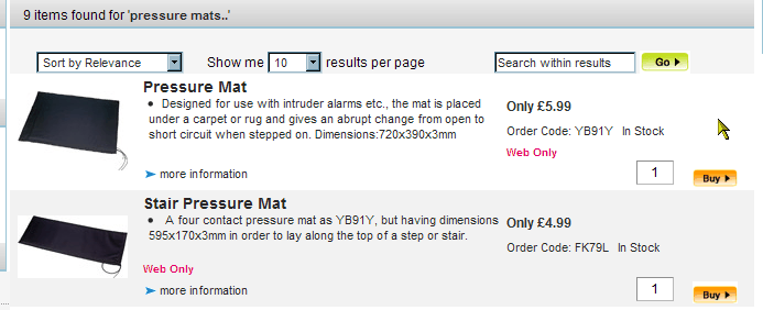

hi danjel,
You can buy from Maplins, floor pressure mats, two sizes, one for passage ways and another for stairway use.
They are not expensive and they last for years when placed under a carpet.
nice!!! that looks like an ideal solution.
