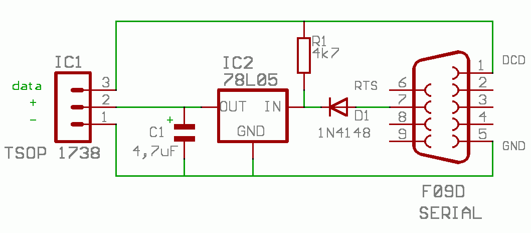

there are some other ways of doing that:
if it does not have to be limited to the lpt port you can use the serial port and the attached file
its great; you are not limited to one keyboard but to as many remote controls as you can find
use girder to configure the whole thing
www.girder.nl
