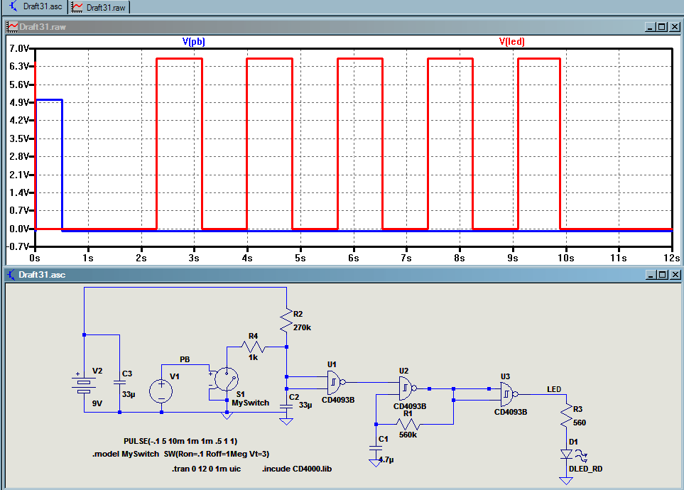

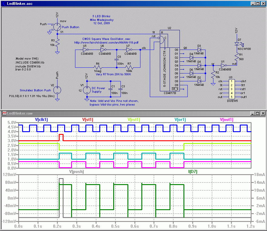

If I want an LED to only blink a certain number of times. Say 5 times. What would be the best way to do that(without a uC). Would it be a monostable 555 to a astable 555? Or is there an easier way to do it will less components?
It doesn't have to be a specific number of times, it just has to be a few.

A simple circuit like this will do the job.:)
The push switch shorts out the 33uF cap via the 1K, on release the LED will flash.
Adjust the cap values to give the number and duration of the flashes.
Here is how I would do it.
