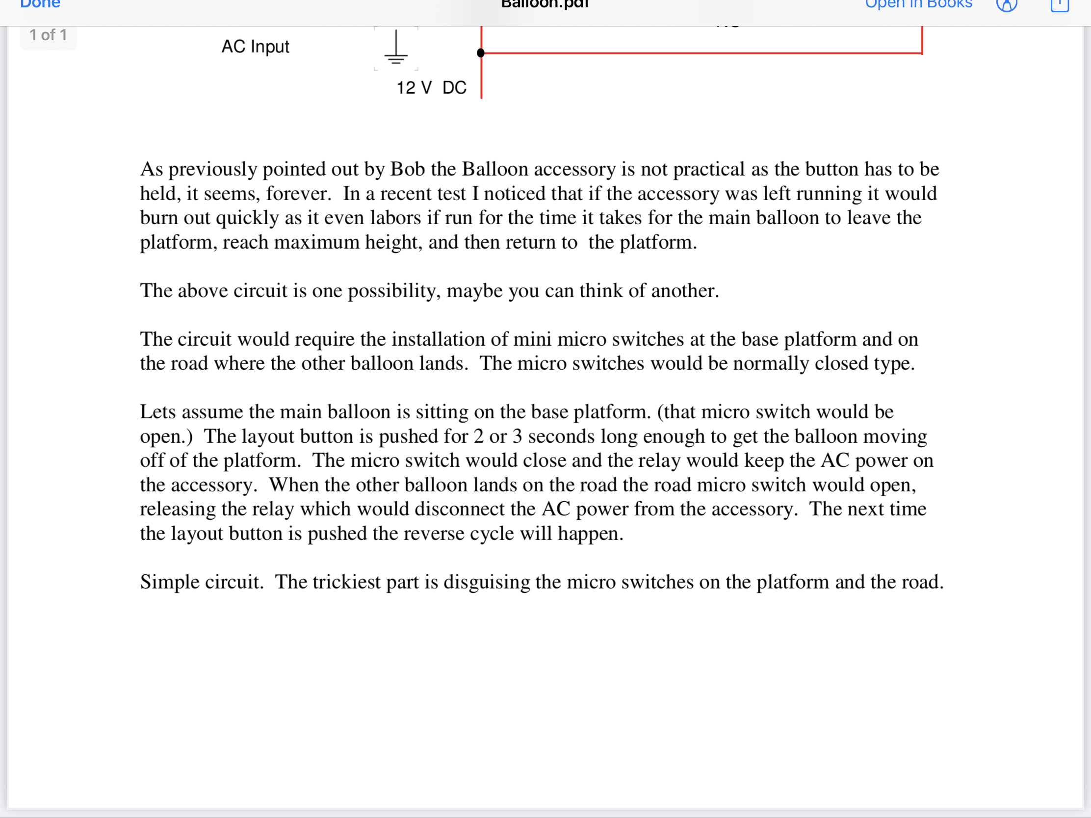

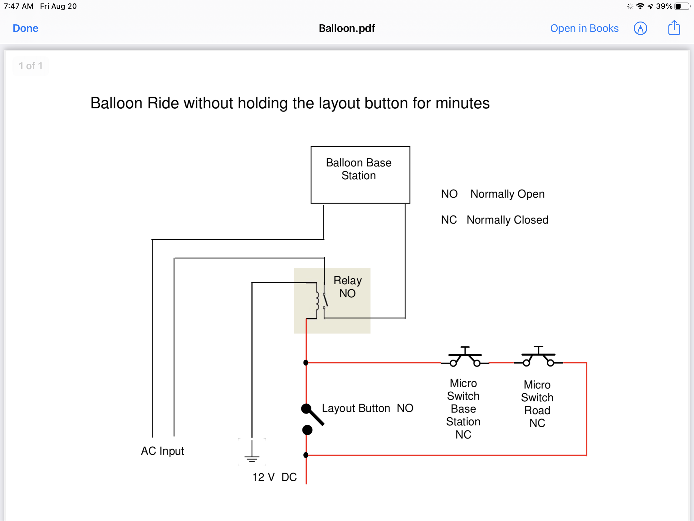

This may not be as simple as you expect. If a model has to be powered for a certain amount of time then any error will accumulate over time and the exhibit will be out of sync. Is there some way to place a microswitch in a "rest" position so it always stops in the same place? You would then just need a latching relay that is latched by the push button and unlatched by the microswitch.
It certainly isn’t as easy as expected, one of the other guys was thinking of trying to mount a micro switch.
The thought was that the TD relay would be set long enough for the accessory to run a complete cycle, at which time it would return and stop as designed.

I agree with Pommie, a stop button would be more accurate, and then it could be controlled with a simple flip-flop circuit , and maybe triggered with a magnetic sensor and a magnet on the train
What stops the accessory now?
Is there a track occupancy sensor available?
Based on what I can deduce by the previous posts (which isn't much) probably just need a latch.
Latch on by spectator button press, latch off by accessory return..
