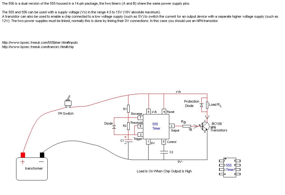

uploaded Picture
I have a attached file you can open to view a diagram i made. I made this Diagram with the help of a web site and some common knowledge, let me know if it makes sense to you. I did this with out a Relay I used a NPN Transistor in its place. I wrote down the web sites so you can see where I got my idea for this to work. It kinda makes sense to me, but as i said im not really quite to sure about it. If you read the paragraphs on the site you will see where i drew my conclusions on how i drew up the diagram. If its a dumb idea please redraw it and send it to my email address please Bof30002000@Yahoo.com. This is just for one timer. I figure make one work before trying to get many to work is my thoughts on this. I forgot to put a dc converter between the switch and the board. Here is the web site i got my idea from. I havent seemed to figure out though how i get the lights to come on with dc. I was thinking maybe 2 power souces one for the boards and one for the lights and maybe a relay or something would turn the light on to the other circuit to complete it or something.
www.kpsec.freeuk.com/555timer.htm#inputs
www.kpsec.freeuk.com/trancirc.htm#chip

The circuit you drew is an astable circuit meaning it will constantly switch on and off. From your description it seems you need a monostable circuit which will stay on after the delay period. If this is correct search for a 555 monostable.

By the sound of it, a 555 timer for each lamp would do, although you'd have to have a circuit for each lamp. If the lights are to turn on one after the other, at regular intervals (50 seconds, except the first was after 30 seconds) then a single 555 timer, in 'astable' mode producing a square wave with a 50 seconds period would do. That, connected to a shift register (with its serial input tied high, +V) would create a 'bargraph' type thing. Every time the 555 timer's output goes from low to high, the shift register will 'shift in' the serial input, which is '1' (+5V) and so light up the next lamp.
I know thats probably quite complicated for your project, but, two chips? Each relay would need a transistor to drive it as well, as logic chips cannot drive realys on their own. I believe some shift registers available have a 'clear' pin, which makes all the outputs 0, which I guess would be your reset to turn off all the lamps.
Just an idea, if you want more details just ask, there are plenty of ways to do this :D
