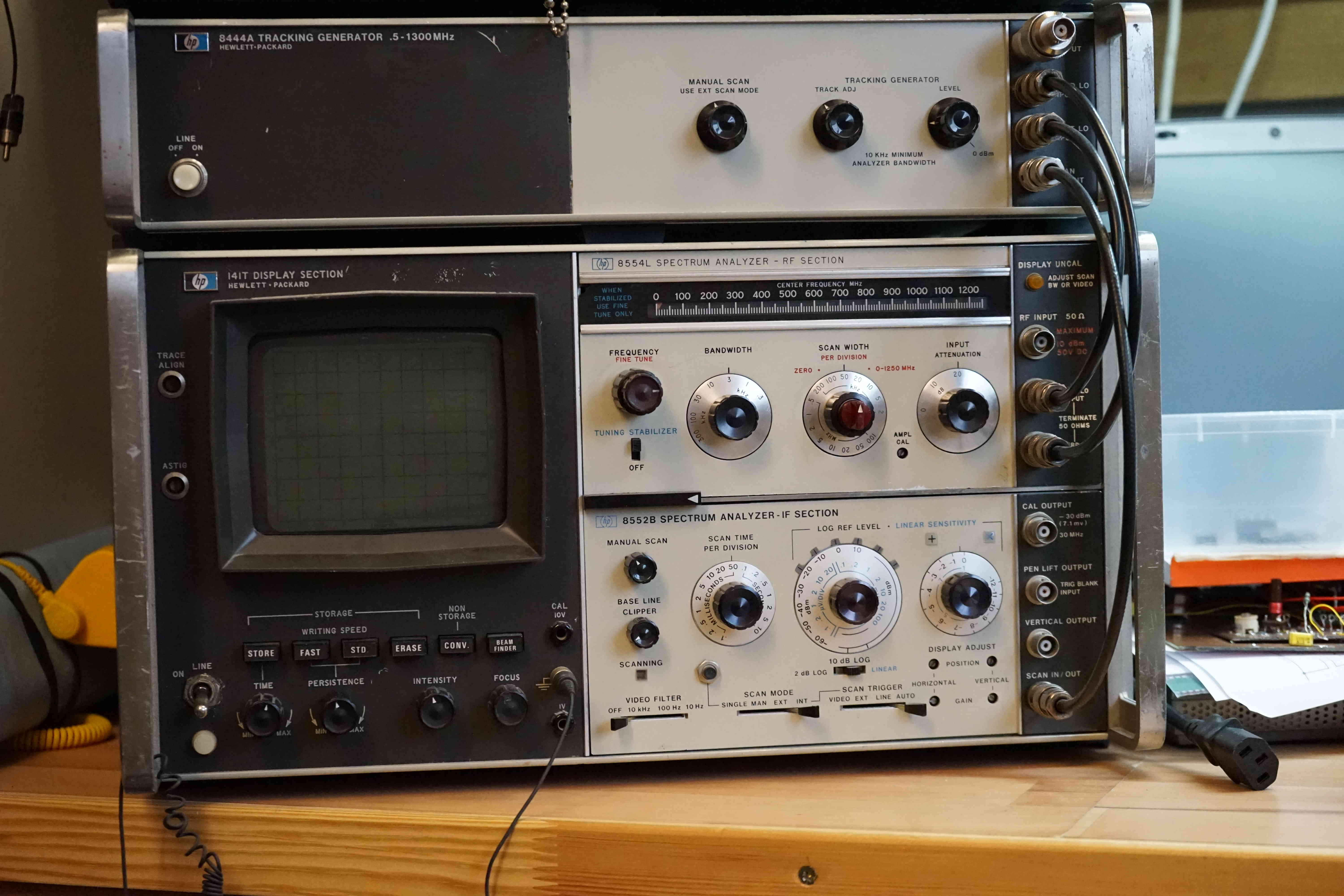

Here is mine:
As you see, I have a Tracking Generator which is most useful.
I also have an 8553B 0 to 11/110MHz RF section which seems to take for ever to warm up so that it is stable and will stay in lock.
As it stands the analyser could do with some TLC.
I spent some time working on it a year or so ago and found that whenever I switched anything, there would be a transient on the 10v (?) line in the IF section and the YIG oscillator would jump to lock on the next MHz setting.
Rather annoying when you are trying to look at something close in.
