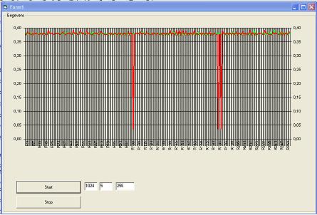

Because i have no idea of what a scope can do apart from the basic.
and i needed one on a sunday, i thought of making one the easy / fast way.
soow i hooked up an pic to max 232 to pc..
and now i send 2 channels from de adc values to the pc.
because i have no idea what kind of functions i need to make in it
i started with the basics..
here a screenshot.
ohja what kind of sample time is wise to use?? uS?? i now use 200..??

This sort of thing is more a datalogger than a scope, it will only have a limited sample rate, limited by the speed of the conversion - and also by the speed of the transfer to the PC.
How fast is your RS232 running?, and are you using 8 or 10 bit samples?.
I agree, this solution is not gonna be fast enaugh... Maybe if you use paralel port, you could get to 600Khz maybe to 1Mhz, but that's it... If you use USB (which is kinda complicated) and a realy fast AD it would look more interesting...
uCs are essentially too slow for a practically useable scope. That's why diy scopes often involve FPGA solutions.

i don't how to calculate it but have tested a bit arround
and i have tested 2 things...in the pic i start with a mesnr 1 wich every measurement i increment it up..
then on the pc side on the graph i replce the graph value with the measure ment value (the colum= mesuere ment nummer).
the problem i saw that the data arrived a bit strange in the port...
now i have deleted that port of code and now i simpel look wich channel and that line add a new value to the next column..
the serial speed = 38400Charc/sec (Baud) the sample quality = 10bit (as you see in my prog settings states 1024 steps 5volt ref.
the sample time is 150uS (think i need to increase..)

You're using 38,400 baud (BPS), that gives an absolute maximum transfer of 3,840 bytes per second - as you're using 10 bit resolution, you need to send two bytes per reading, which for two beams is 4 bytes in total. This gives 3840/4=960 - 960 samples per second, ignoring the time actually taken to read the samples.
Dropping to one beam would double this, to 1920 samples per second, and dropping to 8 bit resolution would double it again, to 3840 samples per second.
As it stands your bandwidth is only about 200Hz or so, and you should put lowpass filters on the inputs at this sort of frequency.
Like I said before, more a datalogger than a scope - but still VERY useful.
