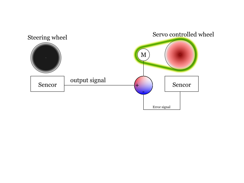

i'm attempting to put together a system that will rotate the servo motor back and forth to a postion in relation to the position of a manually operated position switch of some sort. i'm very new at this type of "quest" so i have no clue. thanks for any assistance.
Hi.
Your description is too general. The concept about distance to a predefined position is a very general description of a servo system.
Maybee if you describe what you plan to build, I may be able to help.
If you are using an off-the-shelf servo as used in R/C models then your manual control gubbins just needs to send pulses to the servo at a rate of ~ 40 per sec. The pulse width is in the range 1ms - 2ms and controls the angular position of the servo output shaft.

Here's a drawing that is a very simplified model of a basic servo:
