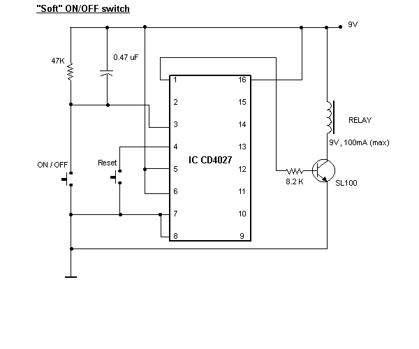

try this... pin 14 and 16 connected to v++ and pin 8 connected to ground
if you have any more questions then feel free to ask. if you need to send some pulses out of those output pins then send the signal in from pin 14
the chip takes maximup voltage of 9V (this is safe power) search for datasheet for more info

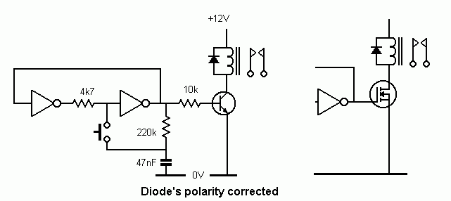

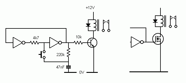

A toggle switch has a short operating lever on it.
This should do what you want.
The circuit round the two inverters is well known but owes its exposure in these forums to Audioguru.
Thanks David, I couldn't find it. :lol:
BTW, your diodes are backwards. :(
Dont' you just hate it when that happens .....
Thank you.

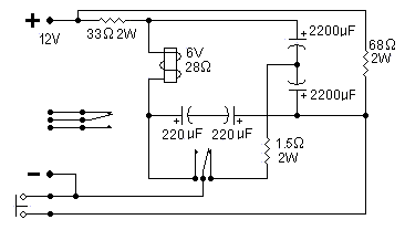

Hi David, which one do you think will blow-up 1st, the diode or the transistor? I think the transistor will blow to protect the backwards diode. :lol:

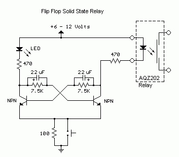

Toggle relay one button.

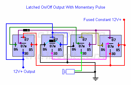

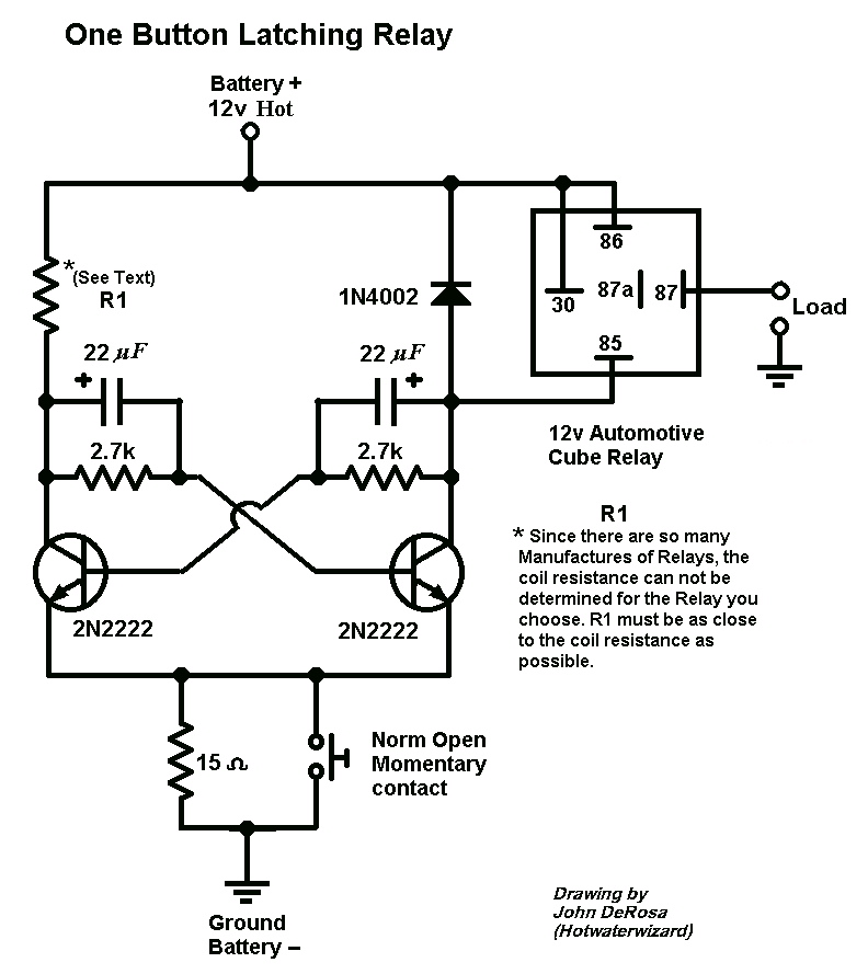

More?
