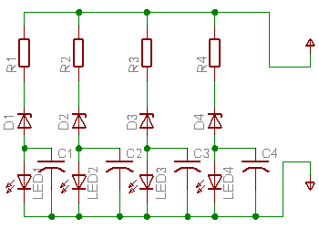

I got this schematic from someone on headwize.com, which has the use of zeners, and I'm wondering how it would connect to the positive and negative wires from from the battery pack. The battery pack was going to connect to pins 1 and 2 on a firewire port, so where abouts does this fit? Oh, a pushbutton is going in there too.. also, I'm sticking with 8 AA now.

The graph of the voltage of a discharging rechargeable battery shows that the voltage barely changes between 85% charge and 15% charge. Today I was at work using my incandescent (with filiament) flashlight with 4 new,
NI-MH AA cells and I used it for about 2 hours when the brightness (and therefore voltage) remained the same, then all of a sudden it got dimmer and quit. The dimming lasted for only 5 minutes. That shows me that you cannot measure remaining charge capacity by measuring the voltage using an LM3914 nor zeners. 2 of the cells were completely discharged and the other 2 still had a lot of charge remaining. The 4 cells came in the same package and were recently charged at the same time so they must have differing capacities. Reading the threads about battery chargers will show how complicated it will be to ensure that a cell or more will not be ruined by reversal during discharge, or all cells will not be ruined by overcharge.
What if the batteries I am using though are completely charged, or what about if I just use Alkaline?
