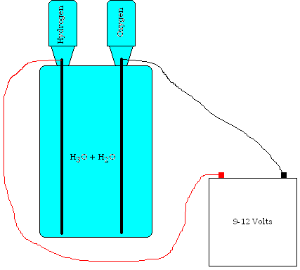

If you want to make large amounts of hydrogen, then i would suggest taking some stainless steel wire/bolts, and then stick them in a jar(glass jar). Then fill the jar half full of Hydrogen Peroxide, or H3O, and the other half with regular tap water. Fill a plastic pop bottle full of water, and the put it upside down in the jar, just above the Anode and the Cathode(Make sure no air is in the bottles). I am not sure what side the hydrogen comes out of, i think it is the cathode. So, - = Hydrogen, and + = Oxygen. I have attached a diagram.

Hydrogen peroxide is H2O2, NOT H30! It is no different than water except that oxygen breaks down out of it fairly easily then it's std electrolysis.
Stainless is not a great electrode. It will dissolve into sludge and release chromium ions which are an environmental problem long after they're flushed down the drain. They're also a pretty high resistance and make a lot of heat. If you want to do a small experiment, it's not a real problem though, just add a bit of salt.
Any real electrolyzer uses an extremely caustic alkaline solution and platinum-plated electrodes. Most do it at as high a temp as is practical because electrolysis is more electrically efficient there, it actually absorbs the thermal energy (requiring less electrical energy) to make hydrogen, constantly cooling the solution in the process. Thus you need a high temp heat source to keep the solution heated.
Yes, i am sorry, H3O is heavy water. Yes, H2O2 Is correct, so you will get equal amounts of each.
Also, correct. I meant aluminum, and copper. I have used many combinations, and it has been a while, so my memory is kinda foggy. Copper corrodes fast, though. Aluminum works great, but after some time, it may need replacing. Salt is ok. If you plan on using salt, i would suggest using Distilled water, with some salt in it. It works very well! Sorry for the mix ups! It has been about 2 years since i played with this stuff. :)

Electrolysis requires only 1.2v. If the resistance of your system- only salt water electrolyte and stainless electrodes- the current will be low. Basically I=(Vin-1.2v)/R. The rest is dissipated as heat. If you're using more than 5v, there's a whole lot of heat being generated!
