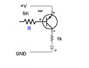

That means IR module outputs goes low when it receive the signal interrupting the normally +ve output. All you need a PNP general purpose transistor wired as follows:
Connect a 5K resistor to the base and goes to the IR output terminal.
Emitter goes to +ve supply.
Connect LED through a resistor(1K) from collector to GND.
You'll get it blinking only when it receives a signal.

I wired an NPN transistor (it's pretty much the same as a PNP, right?) the way you explained, and yes, I only get the LED to blink when it receives a signal, but I was wondering if there was a way to get the LED to stay off, and to blink on when it receives a signal, because right now, it's staying on and blinking off when it receives signal
You need a PNP transistor like BC556/557,2N3906 to get it work. Try increasing the 'R' value in fig if the LED doesn't turn off at no-signal conditions. R goes to IR module output.

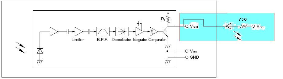

Does the IR module have a push-pull output?
You could connect the LED between the output and the +V.
The IR receiver is from RadioShack. It is surplus without a manufacturer's name and without a datasheet or any spec's.
Most IR receiver ICs have a very low pullup current (62.5uA) and a max allowed output low current of 5mA.
As already pointed out, most IR receivers have a weak pull-up/NPN pull-down.
Assuming a +5 Vcc, and keeping the LED current < 5mA, you could try:
