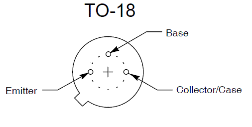

Pin out is the standard TO18 ebc looking from tab format. Same as BC108, 2N2222A etc
